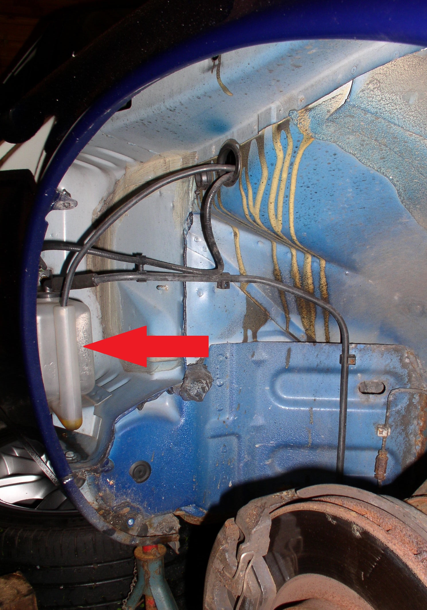

The Atmospheric Recovery Bottle feed pipe goes across the vehicle behind the engine (the ARB is behind the RH wheelarch liner) so it is still a possibility.
Note that the overflow pipe is much closer to the centreline of the vehicle.

OH! That's on the (US) 'Passenger' side.. opposite side of the expansion tank. Given the semi-intermittant nature, and that this seems to happen during higher RPMs, that's a great place to look.. particularly that hose!
