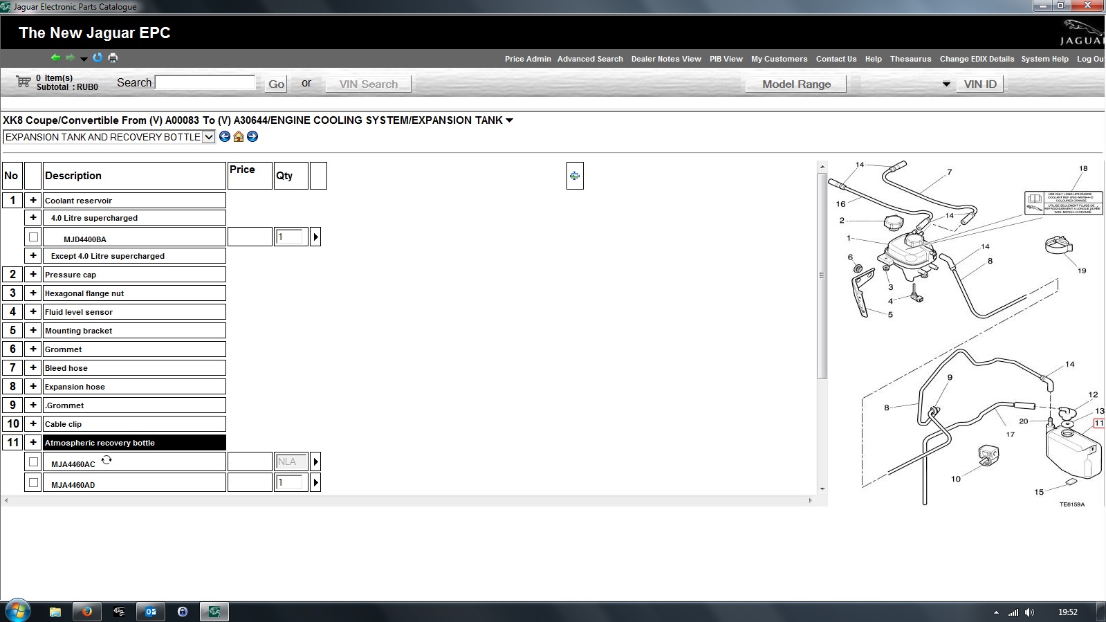

Do you mean the black plastic Expansion Tank (item 1) in the engine bay or the Atmospheric Recovery Bottle (item 11) behind the RH wheel arch liner?
The Atmospheric Recovery Bottle can be repaired but I've read too many reports of disappointing results attempting to patch the Expansion Tank. Far better to bite the bullet and replace it. It comes complete with Pressure Cap (item 2) and Fluid Level Sensor (item 4).

Definitely the Black Plastic Expansion Tank (Item#1).
Thanks for the advice - I don't want to strand myself if it blows apart, and nor would I try to continue to drive a vehicle that was leaking or starting to overheat.
