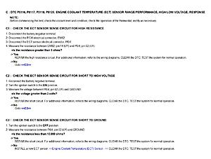

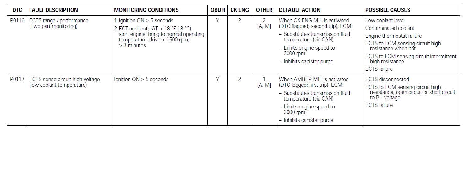

Here's the relevant extract from the Jaguar DTC table for P0116 and P0117:
Although ECT sensor failure is one of the possible causes, problems in the sensing circuit are also on the list.
Here's the test procedure from JTIS for P0116 and P0117 codes:

thanks for the reply. I have replaced the cts and the thermostat. I'll check the harness for resistance next and see if i can find any problems with that. I dont see any obvious problems with the harness so its time to go digging I guess.
