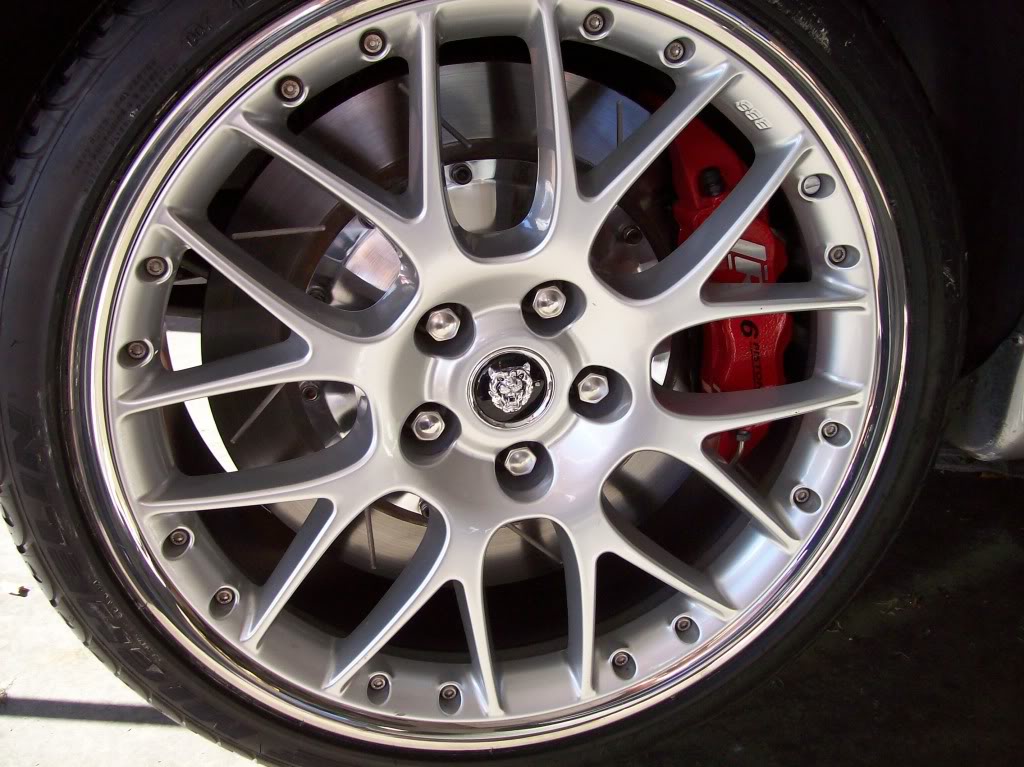

This is what helps me slow down a bit, 410mm discs & 6 piston Alcon calipers.

JgaXkr, your car never ceases to impress !!!

JX;
Sweet!!!!
I second Whitey's opinion.
And your car looks standard otherwise?
What size wheels are you running?
Now I have to check and see what size the 'standard' Brembos are on an '04 XKR.
I am reminded of a famous quote by Ettore Bugatti when asked about the tenuous nature of brakes on his cars:
" I make my cars to go not to stop".
Certainly doesn't apply to your car JX.....

The standard Brembo discs are 355mm & will fit on certain 18" wheels. I use the BBS Perseus wheels in the cold weather with Michelin Pilot AS. In the summer I use Arden 20" sportline wheels, these require a 1/4 " wheel spacer in the front & Michelin Pilot Sport 2 tires.

If I have to ever replace the discs I will go with 400mm as the calipers are pushed out so close to the wheels. When I had the discs made I went with the biggest they could make.

JX;
Thanks....you had the discs made?!?!?!
That sounds very pricey.....will you also cross drill replacements for cooling?
I can't tell and don't know if those are double discs on the fronts there, same for the rears?.
With your Twin Screw top speeds those brakes must be getting super hot when you slow down....no warping issues from heavy high speed stops?

@Jam Warping? Alcons? No chance.
I run Alcon system with 355mm 3 piece rotors (disc, Ti bell, hats) They're fitted with Jaguar's 08' XKR-S pads, Ferodo. Best brakes made, better than AP Racing imho. A great help in fitting from Tony (XKRacer).
I've had fun outbraking friends 911's, XKR's and M3's easily - it's a 1.8t saloon.
