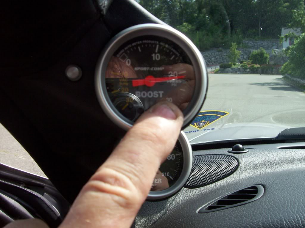

I had the Killer Chiller on my car for 2 years with the Eaton M112. The Chiller is amazing. I think some of the photos in my Photobucket were with the Eaton. As I posted earlier anything other than the Twin Screw is a tweak, here are the tweaks I had prior to the Twin Screw. I will just list the SC cooling mods. The cooling system for the supercharger was isolated from the engine with a seperate resevoir fitted. The hoses for the charge coolers were rerouted (at the recomondation of Tony @ Rocketsports) so the coolant feeds thru 1 cooler & then feeds the second. This cleans up the plumbing on top of the engine. I installed a second pump in the circuit as well as a temp sensor on the discharge side of the charge cooler. We had to reverse the direction of the coolant flow because of problems with the factory pump mounting. I also eliminated the SC radiator & replaced it with a custom made coolant tank in the circuit. The temp from the discharge under normal driving would run around ambient. The interesting thing was under acceleration. The setup I had would produce over 20 psi of boost. I have a boost gauge & a coolant gauge mounted on the a post, so I can moniter both. On a good hard run from 70 to 130 mph the temp would go over 150 ( don't remember exact temp) but as soon as you started to back off on the throttle you could watch the temp go down. I have no idea what the stock temps would be. I know it is lower but it also cools the temp so much faster. The other thing I have done to cool the charge is Snow Performance water methanol injection. The Twin Screw runs app 20 degrees cooler on hard accel than the Eaton. I have no way of telling you which cools faster when you let off as they both go right back down. Think about it you are still well over 100 mph so the concern is more on the road than the gauge.
Thank's for the great info. So with the m112 you still had comparable performance to a cool day on a hot day? I live in the Phoenix area so the cooling is important to me.
