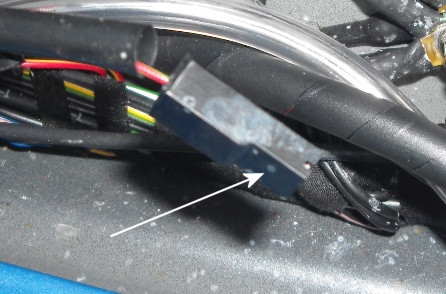

Also, while I was in there, I noticed a couple of "unused" connectors. I am pretty sure that the Three Pin black block connector (2) is for a power supply, but does anyone know what the "Econoseal" 2 pin connector (1)(Brown/Yellow and Brown/Orange) might be for, and also the single spade connector (Green/Red).

don't worry about unused connectors in back trunk area, behind battery, they were used for factory transport for easy battery connections and other things . Each car has a couple , one small black and one bigger gray plug.

One of the connectors seems to be for an auxiliary power socket, see here: JagRepair.com - Jaguar Repair Information Resource
