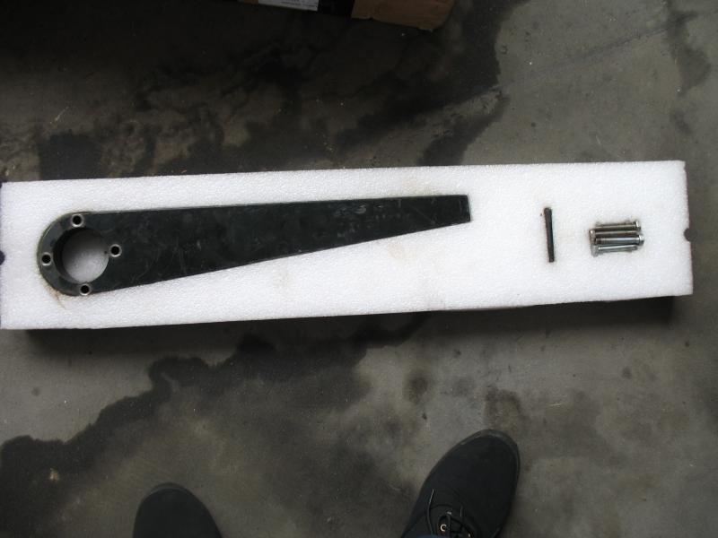

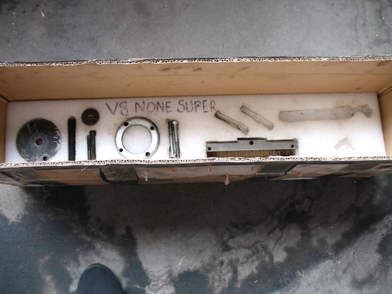

Thanks Sean, it appears i did a number of things wrong, so i'll start from the beginning.
Pics 1 & 2 show how the kit arrived, since i asked for just the crank locking tool, the pulley adapter, and the pulley removal tool.
I stuck one of my camshaft holding tools in the empty slot just to make sure the slot would hold two of them, and from that i figured out that two of the CAMSHAFT locking tool bolts had been slipped in with what they sent me, and it was those two long silver bolts i'd used to try to extract the pulley.
Not good, and doomed to fail.

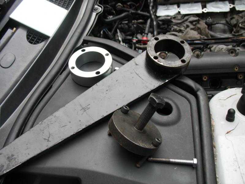

Pic 3 shows why i didn't use the allen key bolts with the extractor together with the adapter, although the diagram in the JTIS shows allen key headed bolts going through the removal disc and adapter.
As you can see, by the time the bolts have passed through the adapter and removal disc, there's hardly any thread length to bite into the pulley threads.

P.S Am i supposed to use the removal disc and allen head bolts without the adapter?
I ask because as the pic shows, the allen key bolts with the removal disc, and the adapter, leaves very little thread to bite.
Yes!!! - it goes like this, (without spacer...) clean/tap threads on pulley, then
1. The little cap button goes into the crank where the bolt came out - (to protect it and make a face for the puller bolt with the ball bearing in)
2. Wind out the big bolt in the puller and wind in the 2xM8 (not M6 my bad) hi-tensile allen head bolts into the pulley until all 3 are snug
3. Crank the big bolt until the pulley pops off.
Good luck with the rest of the job, hope it goes well and the car's back up and running in short order
