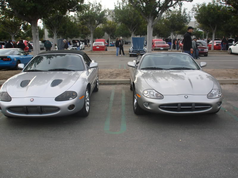

let me know what you find for the side markers as I want to due that as well. If you look at the so cal meet pic's mine is the one with the film on the headlights, brake, and fog lights. The film would not work on the side markers with out grinding down the lettering on them so I am waiting for another option myself

Your XKR definitely looks cool, and will look even better after the Side Lights are done. As I mentioned, I am going with LED Side Lights from Adamesh in the UK. Geoff is going to fix me up with a custom made darker set, much like the tint of the Ardens'. I'll post pictures after I receive/install them.

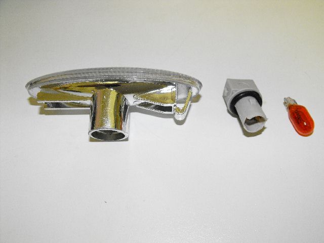

Brian, The "repeaters" are the lights on the front fenders just behind the front wheel wells. Are these the ones you are talking about? For the US market, they were not installed until the '03 model year, but the fenders are pre-punched to accept them. US versions had the Jaguar emblem stuck on over the holes. I updated my '01 XKR with the clear repeaters with amber bulbs. The driver side was pre-wired so the wire just plugged into the repeater light socket. The passenger side is another story. It is pre-wired to a connector under the plastic cover next to the shock tower. The wire connector for this was a nightmare to find. The Jaguar parts departments couldn't find a part number to order the connector wire. I finally found the part number by looking on a friends '05 XK8 wire connector that had the part tag still attached to the wire. I ordered it by the part number and it had to come from Jaguar distribution in the UK. It was about $100!! If this is what you are doing and want the part number for that connector wire, let me know and I can look it up.

Thanks for the offer, but I originally misspoke somewhat. I have already replaced the Red Leaper on the side with an aftermarket one that I prefer. The side running lights in the front and rear are what I am having replaced with LED's w/ dark tinted covers. I mistakenly referred to them as "Side Lights/Repeaters". Thank you very much for the kind offer though!
