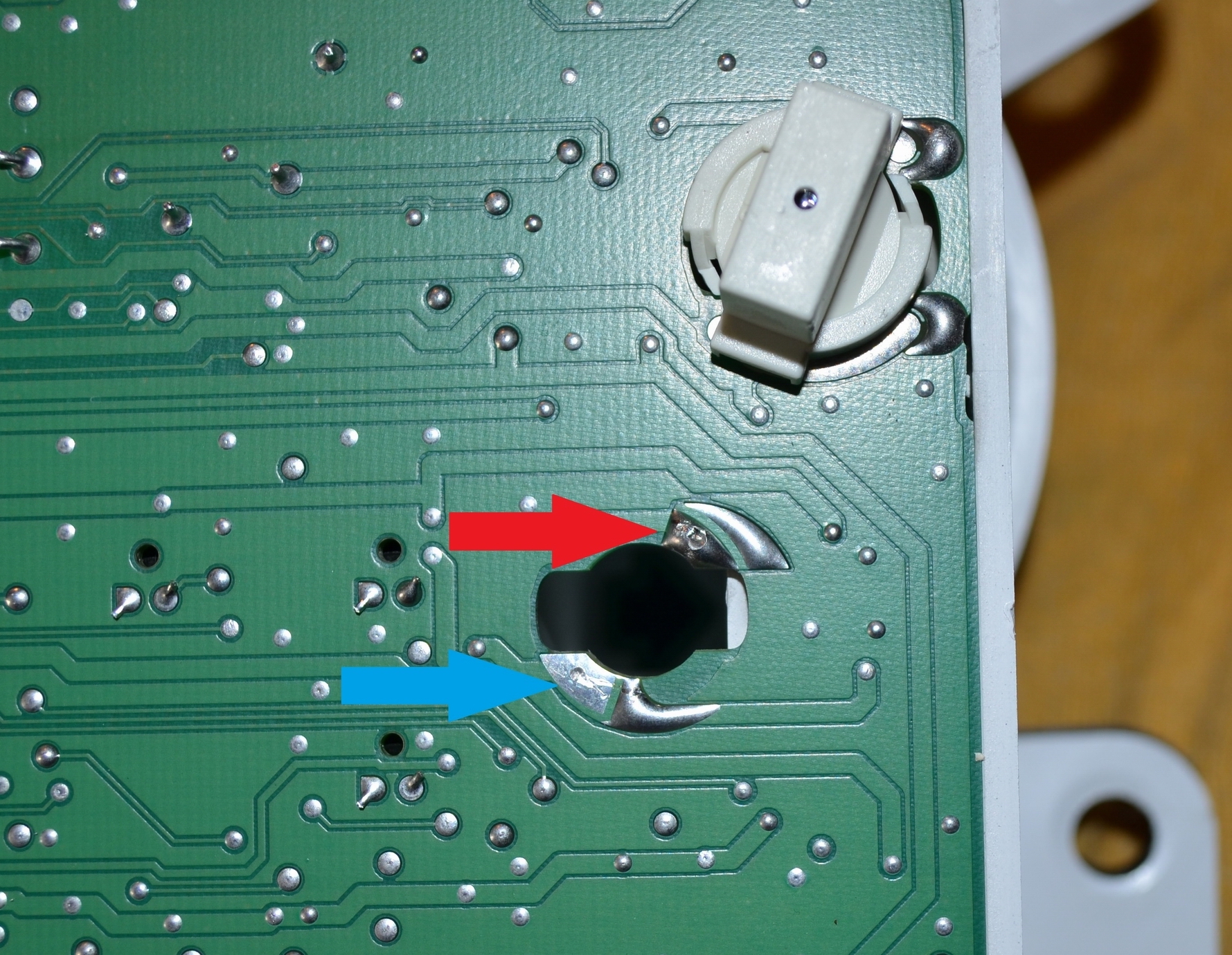

I found damage to the board where two of my IP bulb holders connect (damaged - arrowed in red)
The solder was worn or melted away.
Reflowed the section (repaired - arrowed in blue) and it's been OK for nearly a year now.
This kind of damage could explain intermittent failure of bulbs which can be rectified by a rap on the IP.
