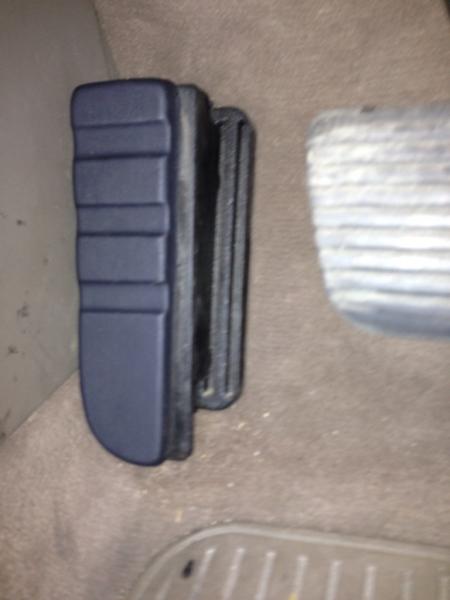

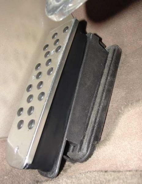

Something I've been wanting to do for 2 years:
Raise the level of the "dead pedal" or foot rest of my '03 XKR.
It's not like I'm particularly short (I'm 5'11"). But with the seat and steering wheel in a comfortable driving position my left foot could not "rest" on the pedal Jag provided for us - It was just too far away to be of any use.
I figured that there HAD to be an adjustment for the pedal, right? WRONG! It IS where it IS.

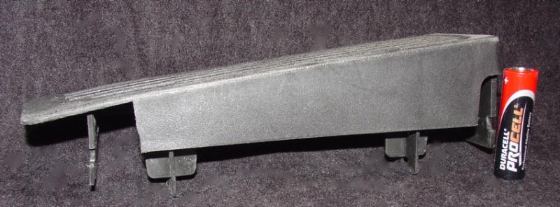

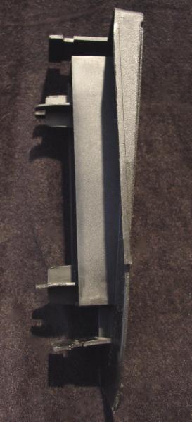

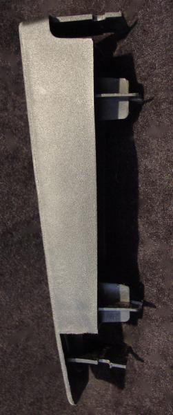

Its hard to see just how that pedal is mounted, so here is a description of Jags design: There is a thick but basically flat plastic mounting plate on top of the carpet. It is secured with 2 deeply recessed 8mm bolts to the floor/firewall of the car. Another wedge shaped somewhat wimpy IMHO foot rest having two attachment male "prongs" designed to press-fit into the female recesses of the mounting plate. With a hard "tug" the foot rest will come out off the mounting plate. On some of our cars the foot rest has a thin polished plate attached to the foot rest by three 3mm recessed allen bolts.
Perhaps the dealer "could" have provided other foot rests of varying heights, but I don't know if any other size foot rests were ever available.
I order to raise the rest in my car, I drew an outline of the top of the existing foot rest and used that to fashion a spacer out of wood - made to place under the polished plate and on top of the OEM plastic foot rest, using longer bolts to secure it. I then pushed the raised pedal back into the recesses in the floor plate.
Piece of cake! Took me about an hour and a half of time and cost nothing but some crap I had laying around my shop. The result can be seen in the first two pics I have attached. Too me, the pedal is now actually useful - and MUCH more comfortable as a foot rest while I'm on the highway.
Now, here's an offer: Forum member The Coupe had an extra foot rest that he very graciously sent me for FREE (this, before I was aware that what he was offering was exactly the same as was already installed in my car). So to pay his goodwill forward, if anyone else out there needs one of the factory foot rests for their XK8 or XKR (I don't believe it is the correct piece for XJ saloons) I'd be happy to send it to you post paid (within the states) First to PM me gets it!
To keep this fine little footrest from becoming the "White Elephant" gift that keeps making it's rounds among forum members, please do what I did not - Get down of your hands and knees and take a look at what you have in your car before deciding that you "just gotta have it!

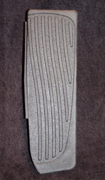

Also included below are pics of the plastic foot rest I'm referring too.

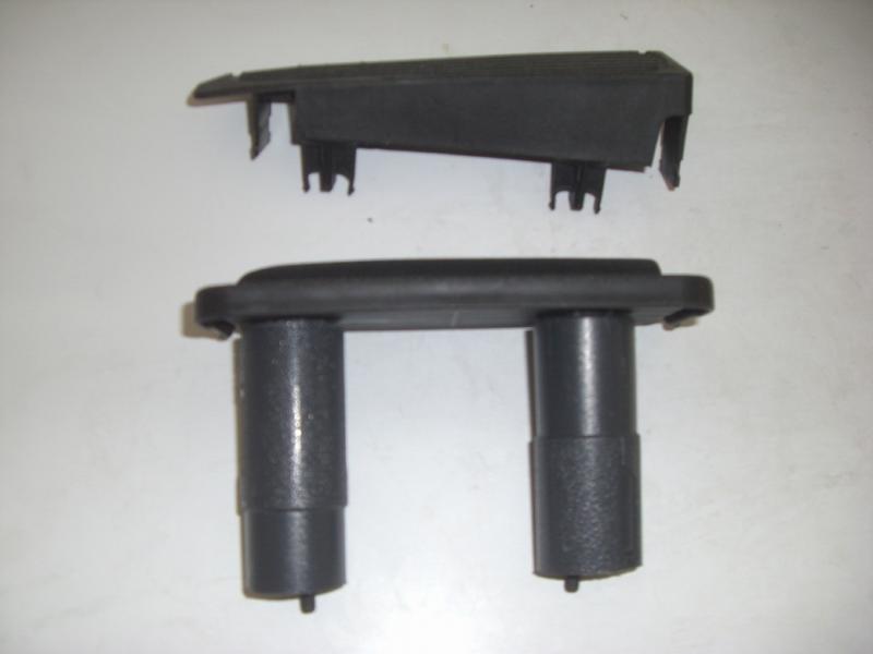

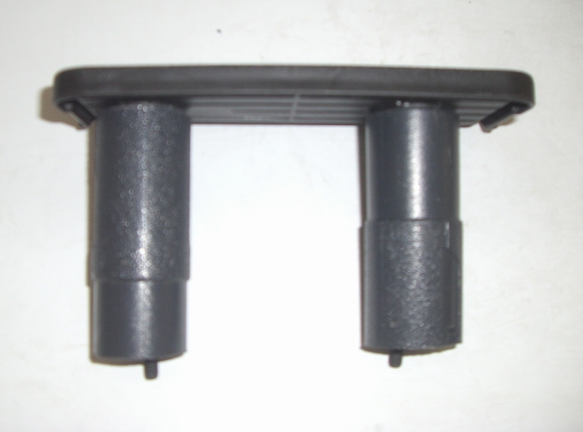

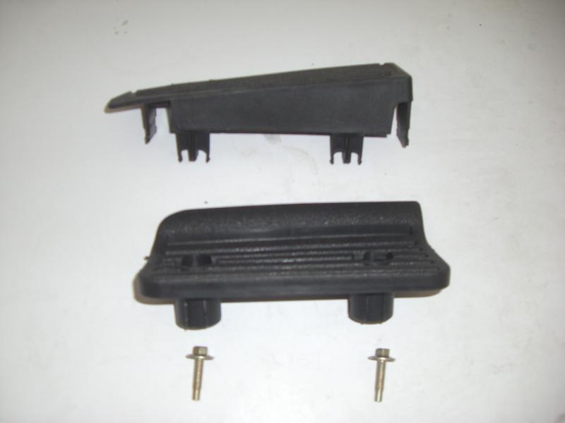

I used two lengths of vacuum cleaner extension pipe and a couple of extra long bolts.
Attached Thumbnails Dead Pedal Mod and offer-dead.pedal.w.risers.jpg   Dead Pedal Mod and offer-dead.pedal-001.jpg   Dead Pedal Mod and offer-deadpedal.assy.jpg   Dead Pedal Mod and offer-deadpedal.apart.jpg   Dead Pedal Mod and offer-dead.pedal.raised.jpg

I've had exactly the same idea of using a wood "shim" to raise the dead pedal but haven't had time to play with it. The vacuum tube idea is also good, I'll experiment with both. I'm 5'10" and find the dead pedal completely useless. Do Brits all have very long right legs? :-)

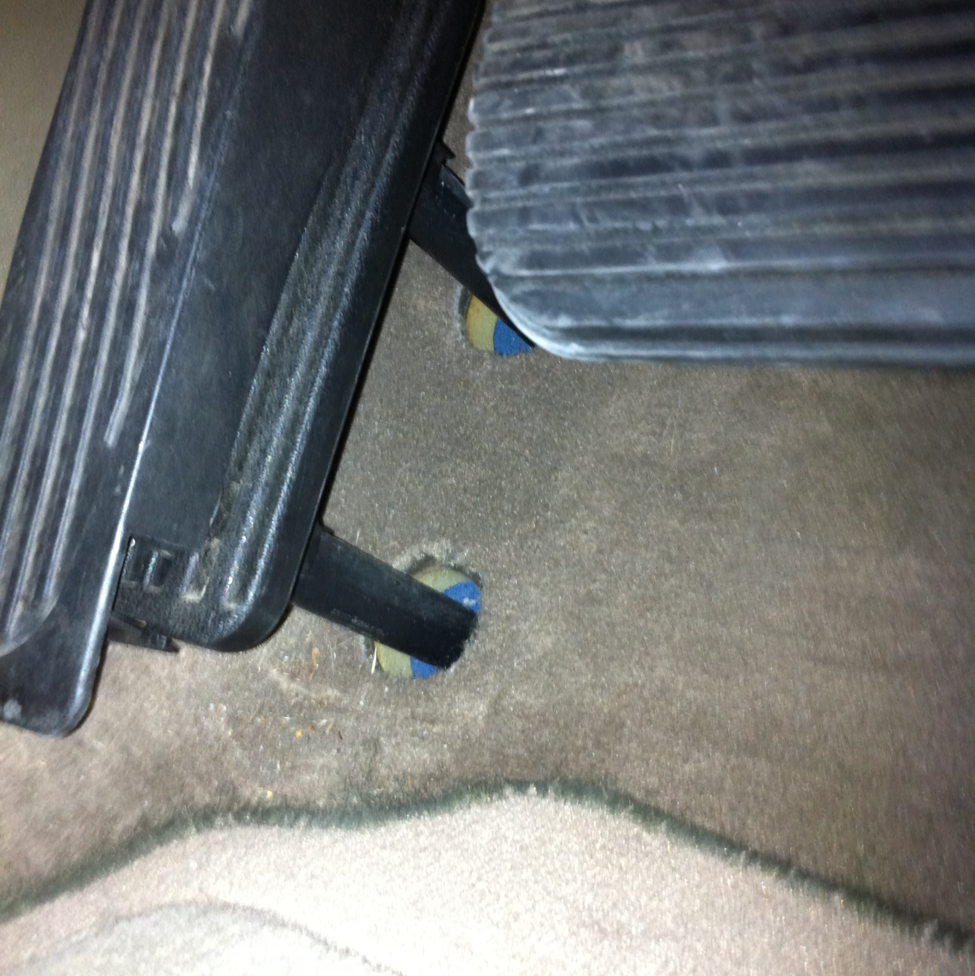

Did GordoCat's modification and it works great. Used 1/2" black sprinkler riser and cut 1/4" bolts down to the length I wanted (I'm 5'11'' and cut the bolts to 3-3/4"). Not perfect fit in an 8mm thread but, it holds well. Cost of modification - $2.12, place to put my foot - priceless. Photos below

DaveC,
I like the look of your fix. Are there any issues with side to side movement? I may have to go longer with mine (not 5' 11'') and am concerned about it wobbling or even snapping off if I put weight on it in the corners.
Old May 28, 2013 | 08:45 PM
DaveC's Avatar
Joined: Nov 2012
Posts: 702
Likes: 133
From: Singapore
If I were to go farther out I would use a larger plastic pipe(see Gordocatcar in this thread). Then it would go over the part that sets into the carpet. When I have my foot on it the pressure goes to the outside of the car and it is quite stable. For the cost of materials a little experimentation wouldn't hurt.
Dave
