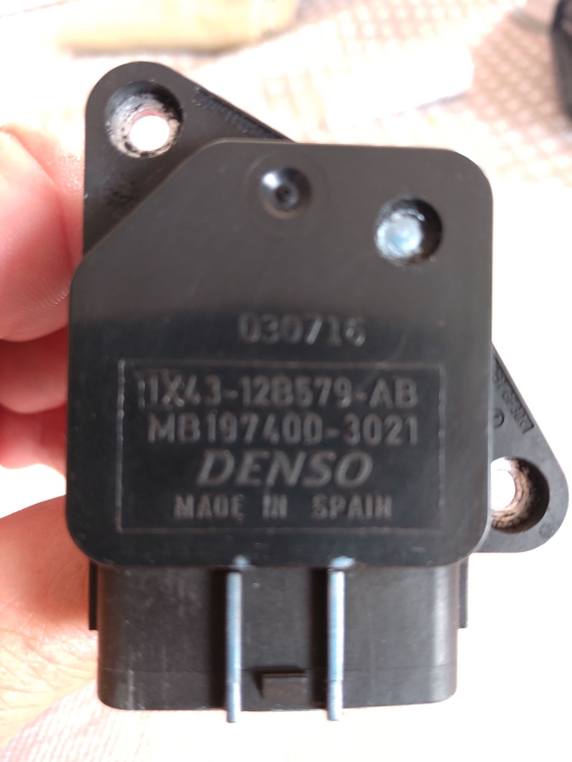

Does anyone know if this Denso MAF marked part # IX43-12B79-AB is correct for a 2003 XKR? The one presently in my car was obviously a replacement and a different number (Picture #2) I can find no information through Denso website. My car runs reasonably well, but like all... sometimes throws weird codes that come and go. I occasionally get "Restricted Performance" which clears upon restarting the car. Any info is appreciated about MAF.
Not currently installed.
Currently in car, and obviously replaced by previous owner.

The replacement MAF on my 2003 Xkr is
Denso 1976040, made in Vietnam. The original one on my car was made in Spain I don’t remember the part number though

the 1x is a ford engineering part number
correct replacement is denso 197-6040 as said above

So...the one presently on my car is incorrect? According to Denso, it's not cross referenced for Jaguar.

The 2003 XKR needs : 2W93-12B579-AC / Jaguar Partno C2C7636
(I have still 2 new unused original ones if interested)
