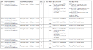

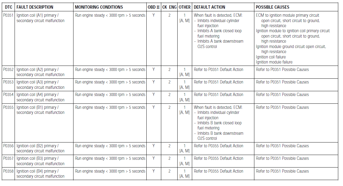

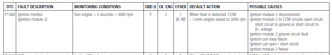

I suspect a poor connection at one or both ignition modules and/or at the ECM.
Open connectors, spray carefully with electrical cleaner (not WD40), and reconnect. Cheap and easy before tearing things apart.
