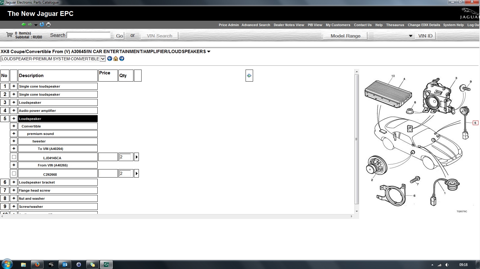

Originally Posted by daro31
Yes the speaker grill as an ALPINE logo on it. .......
See item 5:
Note the P/N change at VIN A40265
