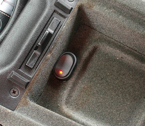

Finally had a nice day yesterday so I installed my switch. I like it, and it took all of 30 minutes or so, including time to soldier in the new switch!

Dave, just now saw your pic...you used the LED switch, very snazzy!
