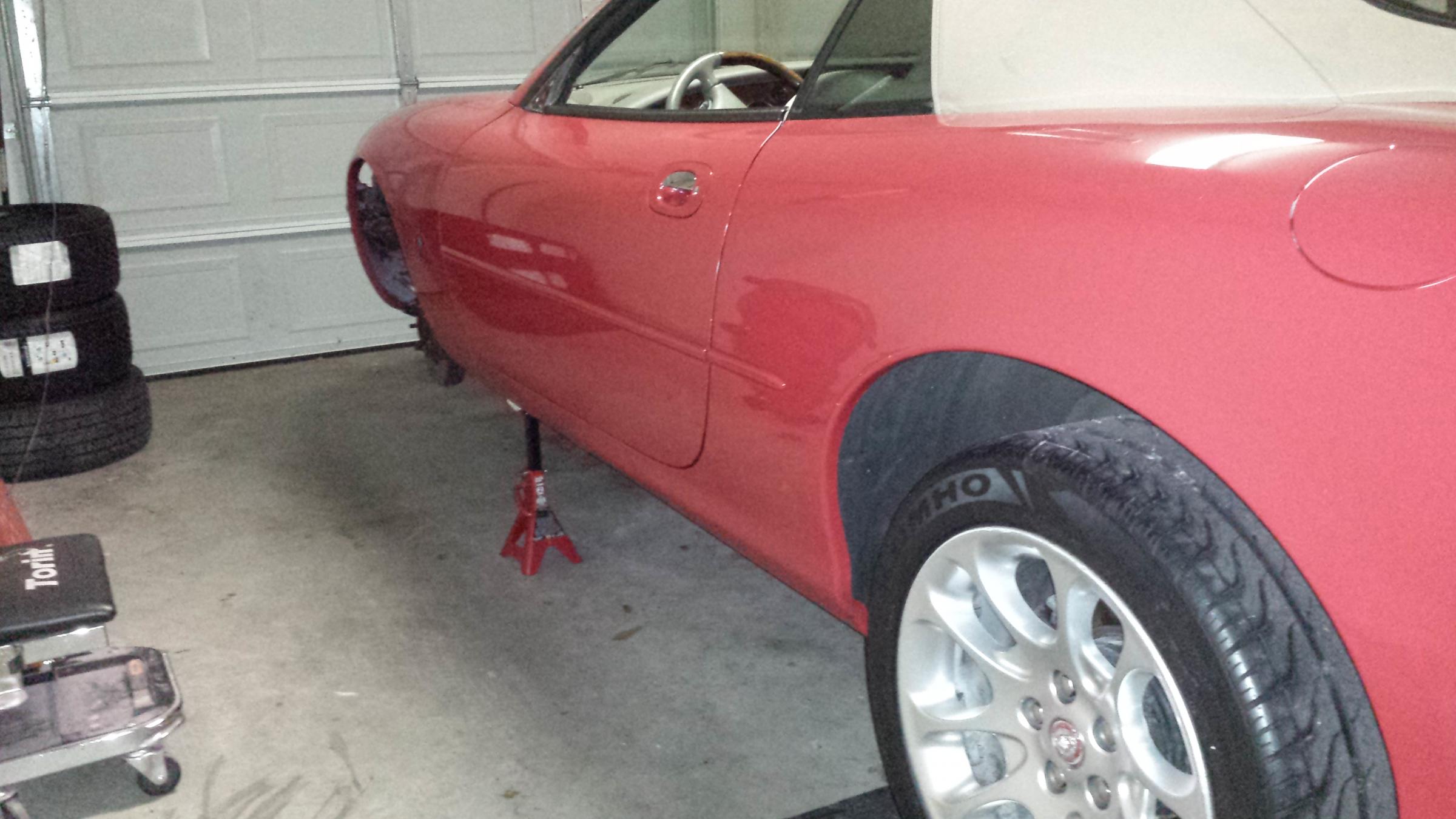

Elevate vehicle on to jackstands, remove wheels and tires, dismount tires from wheels, clean wheels vigorously with cleaner/degreaser. No worries if degreaser discolors paint, your going to sand it off anyway.
Thoroughly clean wheels, remove wheel weights, and valve stems. allow to dry
