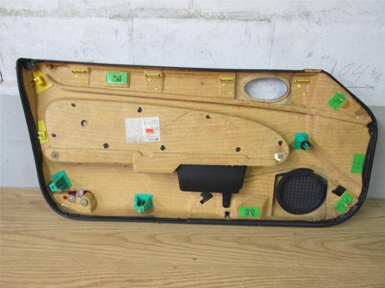

That picture reminded me: the upper left corner of my door panel (based on your picture) won't secure in place on the door. It isn't a major problem, but it does annoy me every time I notice it. I may find that Dr. D's hot glue (or something similar) might be the cure.

That upper left plastic clip is the one most prone to breaking. If it has detached then it can be glued but I'd bet the PO had the door panel off and broke at least one. Both of mine split when I removed the door panels.
Fortunately, Jaguar sells those parts, and they aren't even all that expensive.
RH Clip: C2N3836
LH Clip: C2N3837
Fir tree: KTC100017
Best luck I have had getting the door panel off is to start at the front near the hinge. If you can get your fingers behind the top (upper right in the picture) and slowly work the clips loose.
You will have to pull harder than you expect. Just make sure all of the screws are out.
For gluing the clip back on, I tried hot glue, which eventually gave out on a hot Phoenix day. Replaced that with JB weld 2 part epoxy and haven't had any trouble since.

From the previous photo: The upper left corner tower that holds the plastic pin is gone altogether. Now where do I find one of THOSE?!
There are only four of the eight plastic pins. Three others were broken and, ... get this.... he tried to GLUE the posts together. Oh yeh - that worked well. I'll try and modify some pins I got from NAPA and see if they'll work.

You can order those posts from a dealer, that is what I meant by "clip" in the earlier post. Pretty common to break and the repair procedure is to remove and replace.
Gaudin has them listed for less than $2.
