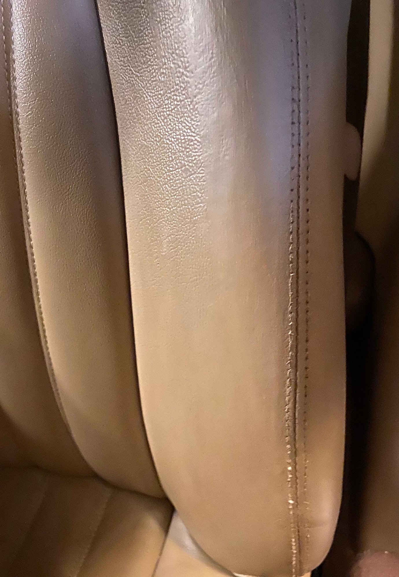

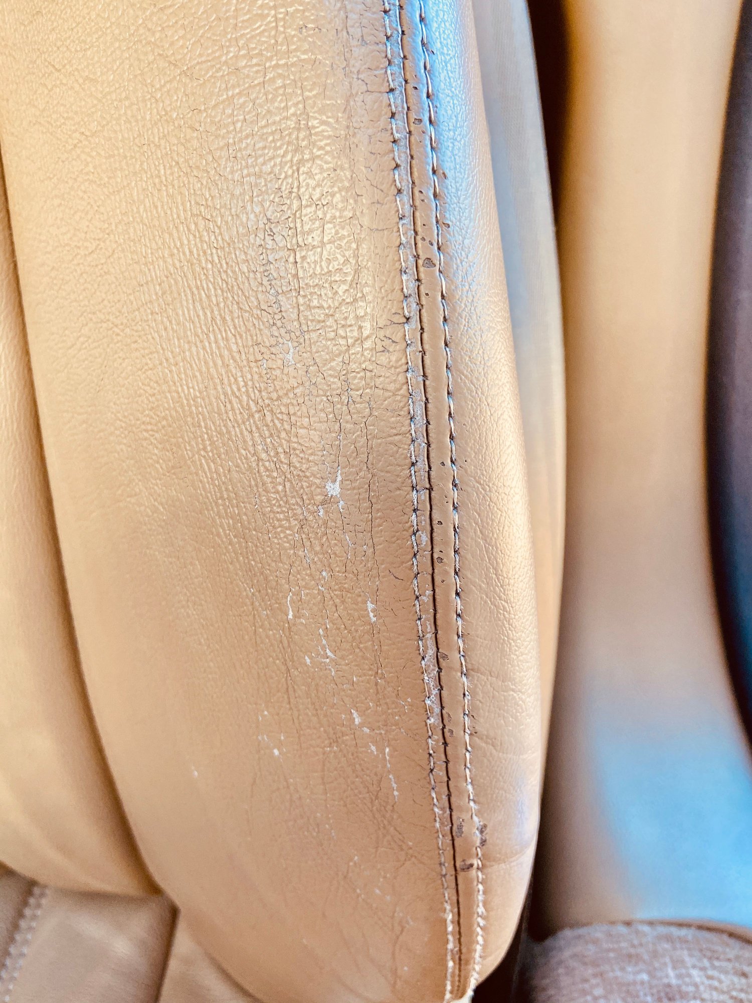

So decided to try my hand at repairing cracking and wear marks on driver’s seat of my ‘97 xk8. Found AutoLeatherDye.com , good reviews/kits,videos....and matched leather dye in the kit. Have to say that I’m thrilled that I didn’t screw it up. Couldn’t do anything about seat stitching, for now, but the repair itself isn’t half-bad(a nail-biter).
Before
After

Hi..., in my case, I took the interior code off of the door panel info, looked up the code online and found that it was “Coffee”. Previous owner had a bottle of dye in the trunk labeled Jag 16, but not knowing if it was a match or even if it was useable ....I ordered the “coffee” from the company. Lo and behold, it was labeled Jag 16! It was a spot-on match.
Being VERY new at this(and admittedly not nearly enough light in work area), I am having to correct one small seat area. And add more lighting. Pray for me
