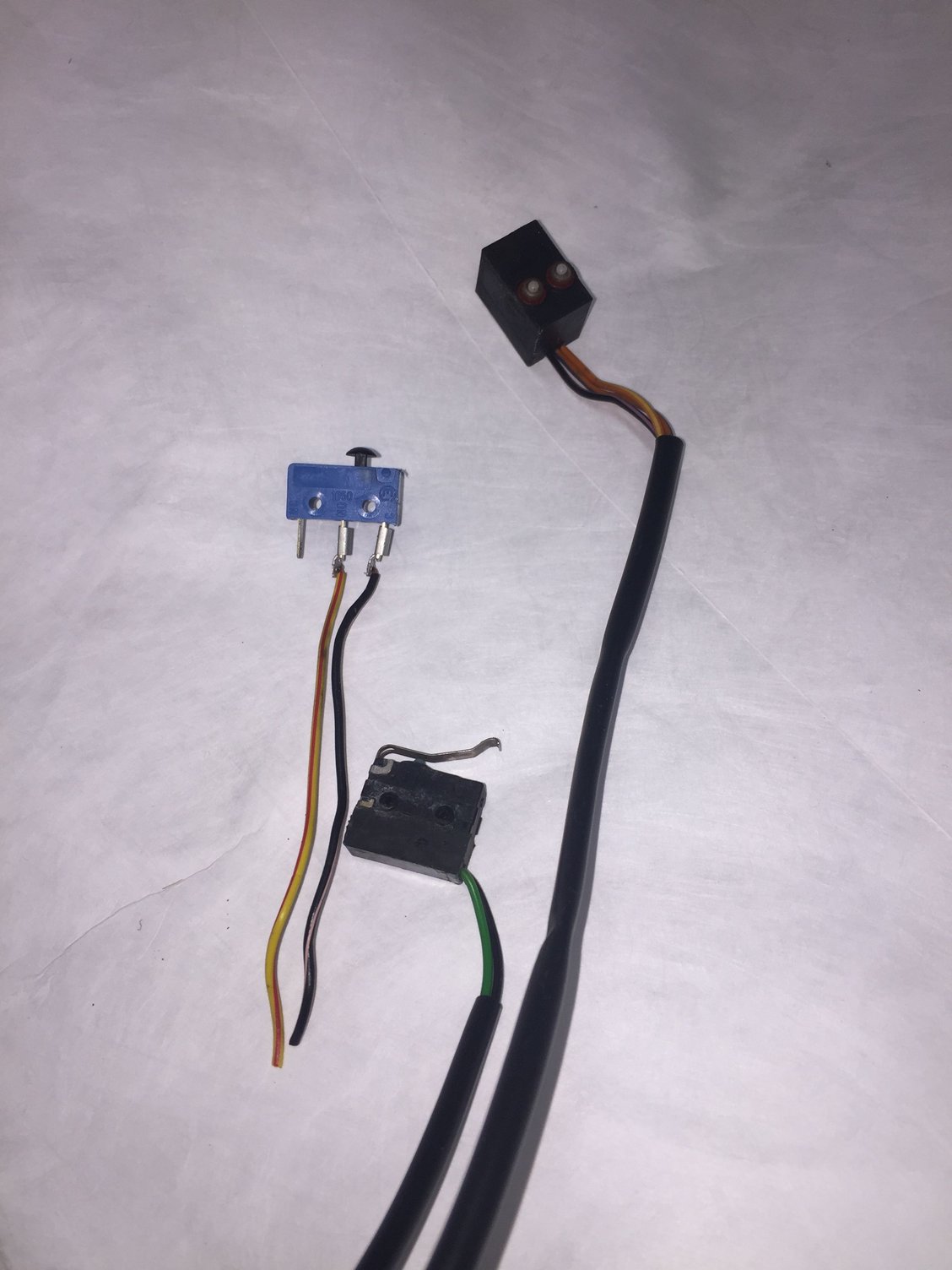

I got all my parts in and installed the lock actuator to my existing latch assy. It works perfectly.
These are the three microswitches that I have left over. The blue bodied switch is the switch located inside my original lock actuator. The other two were mounted externally on the body of the latch assy. that I bought on eBay. They are for another model Jaguar so I am not certain they apply to our door latches. The bottom switch with the green wire appears to be similar to the Omron D2SW-3L3MS .

Jon, that looks like the typical micro switch, so we need to get a better understanding where it's located. Can't be much to replace, just the arm adjustment might be the only thing as it does look plug and play.
Wonder if the wires need to be soldiered into the plug wires or if we can get the old ones out and have the correct ends to insert these?

I am guessing that the wires will have to be soldered. Looking at my new Omron microswitch, I am not sure if it can be taken apart without breaking it. We will figure it out one way or the other when the time comes....

You can try, it is normally pressed together on plastic pins. I would not use a tool, but maybe a finger nail. If you manage to open it (it just pulls apart), pay attention to the little parts inside. There is a blade for the clicking action that needs to remain at the right spot. I agree that if you manage to open the body, there is an off chance you might be able to swap the "legs" from the old body to the new one and avoid soldering. These legs are just pushed into a channel in the plastic body, nothing complicated. The other idea is to open the old body and if the blade is broken, somehow swap it with the one from the new switch. FWIW, even if all of that is possible, it is probably best to just swap the entire switch. On a scale of 1 to 10, the required soldering skills are maybe a 2.
