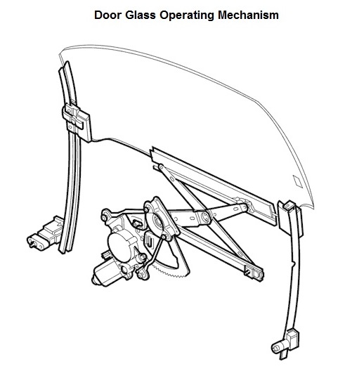

This is what it the mechanism looks like:
Watch your fingers around the X - one of our members reported a near miss a few weeks ago when a faulty motor he was troubleshooting powered on unexpectedly.

With the help of Sam's video, I removed the door panel and as you can see, it wasn't the first time it had been removed.
The glass has definitely popped out of the channel.
The X frame I assume is held in place by the four T25 bolts and as you can see they all have moved.
Do I slacken/remove them to get the glass back in place? Oh, I HAVE disconnected the battery!

I honestly cannot see the problem from the pictures but as I suspected the glass has come out of the channel? If it were me id try and grip the glass to put it back in. Could you physically move the mechanism upwards, again watch fingers, to a place where you can grip the glass from the top and manipulate it back into the slots?
It also looks to me as if the plastic barrier has caught up in the mechanism? Or is it where you have pushed it? Has the plastic jammed and forced the mech to stop and move? If it is jammed try unjamming it first and connect the battery back up, without putting the panel back on, and see if it is the plastic jamming.
I would avoid loosening anything at first. As I said try lifting and moving first.

We need better photo, more specific questions to help better. Is the arm (s) disconnected?
Btw, don't forget you can hold the glass inand up position with any quick grip clamp . Photo:
