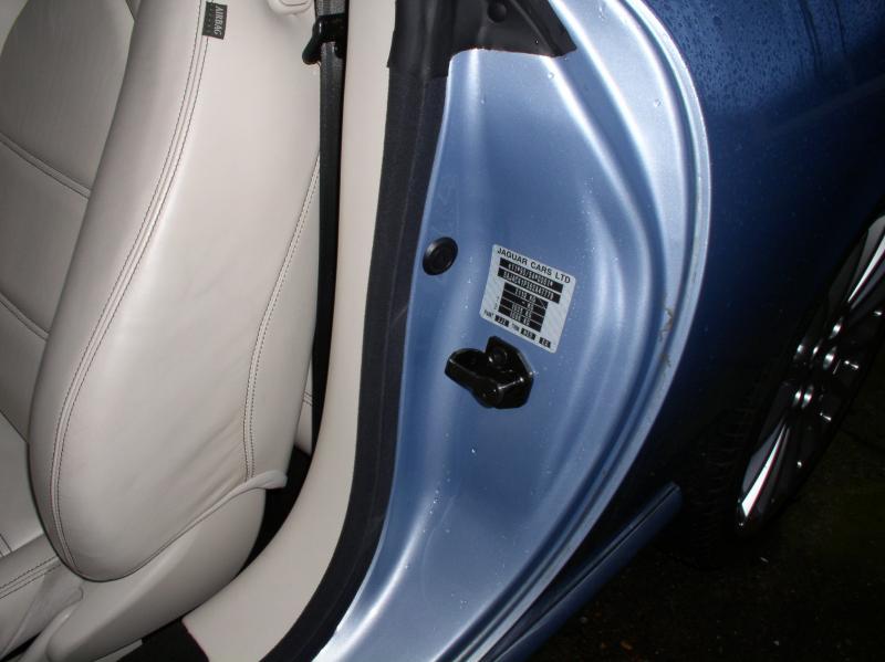

I just picked up my car as I had two panels on the drivers side replaced, looks like brand new, now would like to order some seat dye.
How do I figure out what color my seats are to order some dye?
I have a 1998 XK8 in "black" colored leather, but what is the specific "color" I need to order?
Thanks!
Old Mar 16, 2012 | 06:23 PM
  #29
Thanks!
You'll find the 3 letter paint and trim codes on a label on the door pillar.
Post them back here for the decode.
