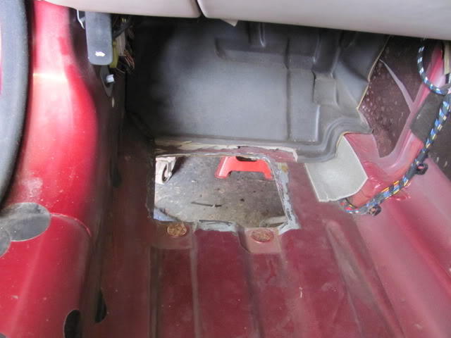

Cut it out and dont be squeemish

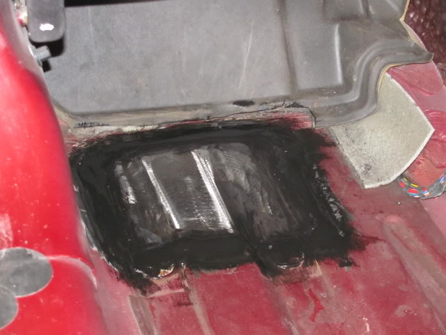

Make a panel with a matching rib pattern and seam weld it in

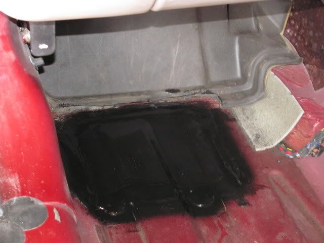

Paint it, this car was changed to a dark grey so I used black

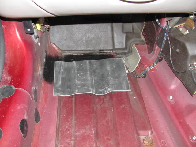

Then stick a rubber mat to it for good measure
