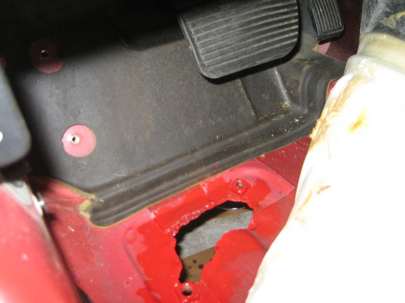

Among other items I have found while having the car in the air for a month is driverside floor rot, 1999 xk 8 coupe. Well I started picking and by the time i was thru I have a 4" x 6" hole in the floor board right now. No picture yet, tonight. It looks like it began under the mickey mouse factory steel plate that covers the manufacturing attachment points. This is just behind the seam where the fire wall attaches to the floor pan on the driver side. follow the brake line and where it makes the two 90 degree bends to go to the rear. Look closely and you will see two plugs opposite each other. Well its hollow underneath this patch. That is where it began . The plan is to get all the loose stuff out. grind to new metal. treat with rust primer, coat with rustoleum, fibreglass over the hole on both sides, add a new aluminum plate where the metal was and use PL adhesive caulk as the sealant bed and anchor thru manufacturing mount points, then a liberal coating with truck bed liner. Was not looking for this at all. If you have not looked to see if your car has this rot you may not want to. It is a pain in the rear without tearing the whole driver side apart so you can work in there.
Not a happy weekend. Something else to do.

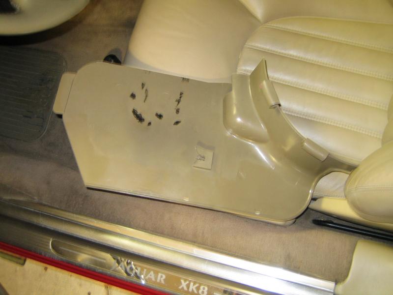

Well my hour is up and here is what I have ahead of me.
The first photo is my new project.
The second is the back view of the driver kick panel. you pull it straight towards you to release off the clip.
The third photo is of the clips that are hidden under the black trim weather strip along the sill and up the jamb. to remove just roll the weather strip up and look under to see the clips. just work with it and you can figure it out. Next thing to clear it the hood/bonnet release. I did not remove this but held it open until the kick panel cleared it.
The fourth is the clips on the foot rest that will release the foot pad off the mounting bracket. the same clip is on the top and bottom. Just use a wide blade and pry open. Once open pull it towards you. this will expose two 8mm bolts that hold the bracket to the floor.
The more I look at this mess of a factory cover plate they would have been better off with just the plastic plugs and some goo on them and not this metal plated mess.
The fifth us the bracket un-assembled.
Thank you for the epoxy comment. I like it better not because its easier, really it is but I do not want to deal with moving that brake line and all that intails to be able to weld a plate under there. Its going to be hard enough getting the goo to go around all the seams. I cant see them welding it from the interior
and ending up with a whole lot of pin holes every where from weld splatter. But I wont hurt to ask about the welding. I knew I should have learned that trade when I had the chance.
Attached Thumbnails Drivers side floor rot, what the @#$%^&*-img_2280.jpg   Drivers side floor rot, what the @#$%^&*-img_2278.jpg   Drivers side floor rot, what the @#$%^&*-img_2279.jpg   Drivers side floor rot, what the @#$%^&*-img_2282.jpg   Drivers side floor rot, what the @#$%^&*-img_2284.jpg
