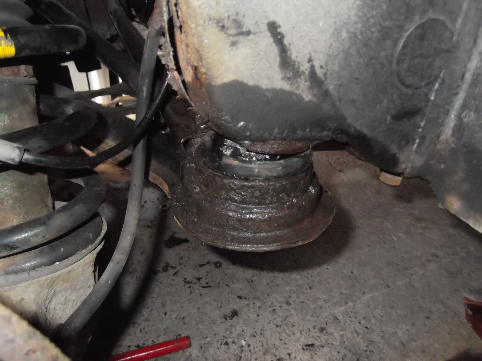

OK - everything is unbolted.
Dropped the subframe enough to undo the b***d exhaust clamp bolts.
Prop shaft was easier with my mate holding one spanner and me the other.
But am in a bit of a mess now !!
near side (UK car passenger side) has come free but the drivers side is stuck solid on the big a-frame mount at the front (where the bush fits over an ali tapered 'pin' under the chassis member just before it goes up around the wheel.
Have crow-barred it so much now I am worried that I may be deforming it.
Have spent 3 hours trying to free it - put tons of wd40 there hoping it will come loose.
Any ideas?? (help )
Thanks - Mark

Looks a bit tight!
A flippant comment would be - put it al back together with loose bolts on that mount and go for a drive. Don't think you fancy doing that.
The mount has an aluminium inner that has the usual unpleasant reaction with steel. Warming it up may help, and a dose of acid alloy wheel cleaner or phosphoric acid rust eater might just eat away enough oxide to free it up.
The aluminium inner is tapered, so one the taper is "cracked" it should pop off happily.
WD40 is not a good penetrating oil as it is intended to hang around, protect and lubricate, which it does to an extent, but is is compromised in all these areas so it can do all things to some extent!.
A fork type balljoint splitter may also help.
Best of luck!
And while I remember, make sure your ABS cables are moved well out of the way, I moved mine over the exhaust boxes to be sure.

Could the whole frame be tilted slightly such that the pin is hung up in its socket? Maybe temporarily reattaching the near side would square things up again and allow you to drop the subframe bit by bit on both sides - if that makes sense.

Funnily enough my mate thought the same, that the 'stuck' bush may be twisted but I reattached the other side and it made no difference.
Funny thing was that when I removed the main bolt through the bush on the stuck side I swear I saw some water come out so maybe its corroded to pieces.
I intend to get a wide impact ball joint splitter and a Jeremy Clarkson hammer and encourage it to come free, but preparing myself for the worse, can these alloy pins on the chassis members be replaced if they get damaged?

Instead of WD-40, try ATF and acetone at 50/50 squirted all around and left to soak.
Lather, rinse, repeat. Time is your friend here.
Then you need one of those pry bars with a small pivot at the end that will fit in
the bolt hole. There is at least one picture around here of someone using one to
remove that bush with an accompanying description.

The alloy part is the centre of the bush, the pin on the chassis leg is steel. Worst case you'll bugger up the bush but if it's that badly corroded it's probably done for anyway.

Scoobie is probably going to be needing a new A-frame. When it is removed a bit of tapping will probably find a fair few holes. I have kept my perforated A-frame with a view to manufacturing a replacement as some point should new ones be NLA or extremely expensive (which they are!)

Spent another hour on it tonight and its now off
What didn't work for me -
crowbar
hammer
WD40 (or at least it didn't appear to help)
steel bar in bottom of bush - trying to lever
Ball joint splitter
shouting and swearing at it
The sequence that did work -
Using a sharp blade to cut away the front of the rubber at the top of the bush exposing the top of the alloy part of the bush
Drilling 3 holes from the top to as far down as I could get (as the inner is steel it appears easy to feel when you finish drilling through alloy)
Hammering a chisel (big screwdriver) in to open up the joint
using the edge of a ball joint splitter to finally drive it down.
