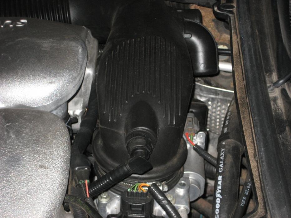

I am very interested in that set up as well. My XKR has the breather where the induction tube enters the TB - it is 90 degrees to the TB opening. Do you also have it routed into the fender well for cold air?
Please excuse the dust, ran through a little dust storm here.
Easy Fix For P0171, P0174 and/or Cracked Air Duct-intake-001.jpg
Easy Fix For P0171, P0174 and/or Cracked Air Duct-intake-002.jpg
As far as I have been able to tell the induction pipe is the same for both Euro and US XKs (Rs and 8s are different I was going to put an XK8 pipe on to eliminate all those parasitic sound control tubes but your set up is so much better)

No goofy baffles on mine, and ive got the same breather stub as marc. Crappy pic attached from my phone. Strt brace? I didnt think that was possible?
