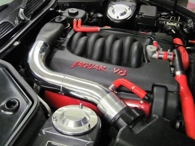

I actually now produce and have in stock some nice easy to fit induction pipe, these are meant mainly for the 4.0 XK8 or XKR
Tony-
Once again, that's a great looking engine bay, and a normally-aspirated one, at that. Very nice.
A semi-stupid question here...what effect does a silver metal intake pipe have on intake air temperature? Seems like the metal would hold more heat than the plastic intake tube, driving post-MAF air temperatures up?

Originally Posted by The Coupe
Tony-
The pipe does get warm in standing traffic but as soon as you move the temperature drops back to normal, you should have a heat shield over the top of your cat which does protect the induction pipe a lot, I see many cars when this has been removed.

Wait a minute though. Isn't this part suppose to be able to flex slightly to accommodate engine movement? (Hence the somewhat useless accordion part). How does the fabbed part take account of that?
You dont need to worry about engine movement, the air box is not exactly fitted, only by a rubber cotton reel mounting and 2 pegs going into grommets, plenty of movement there
