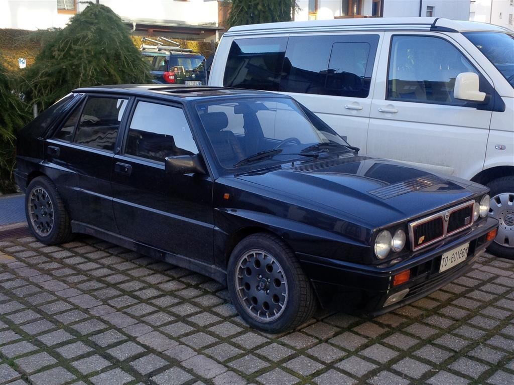

Ot for fmerz: this is one of the 2.....

I have owned a few Lancia Zagato's. Fun old car.

Was too young to own one of the last Fulvia Zagato.....
