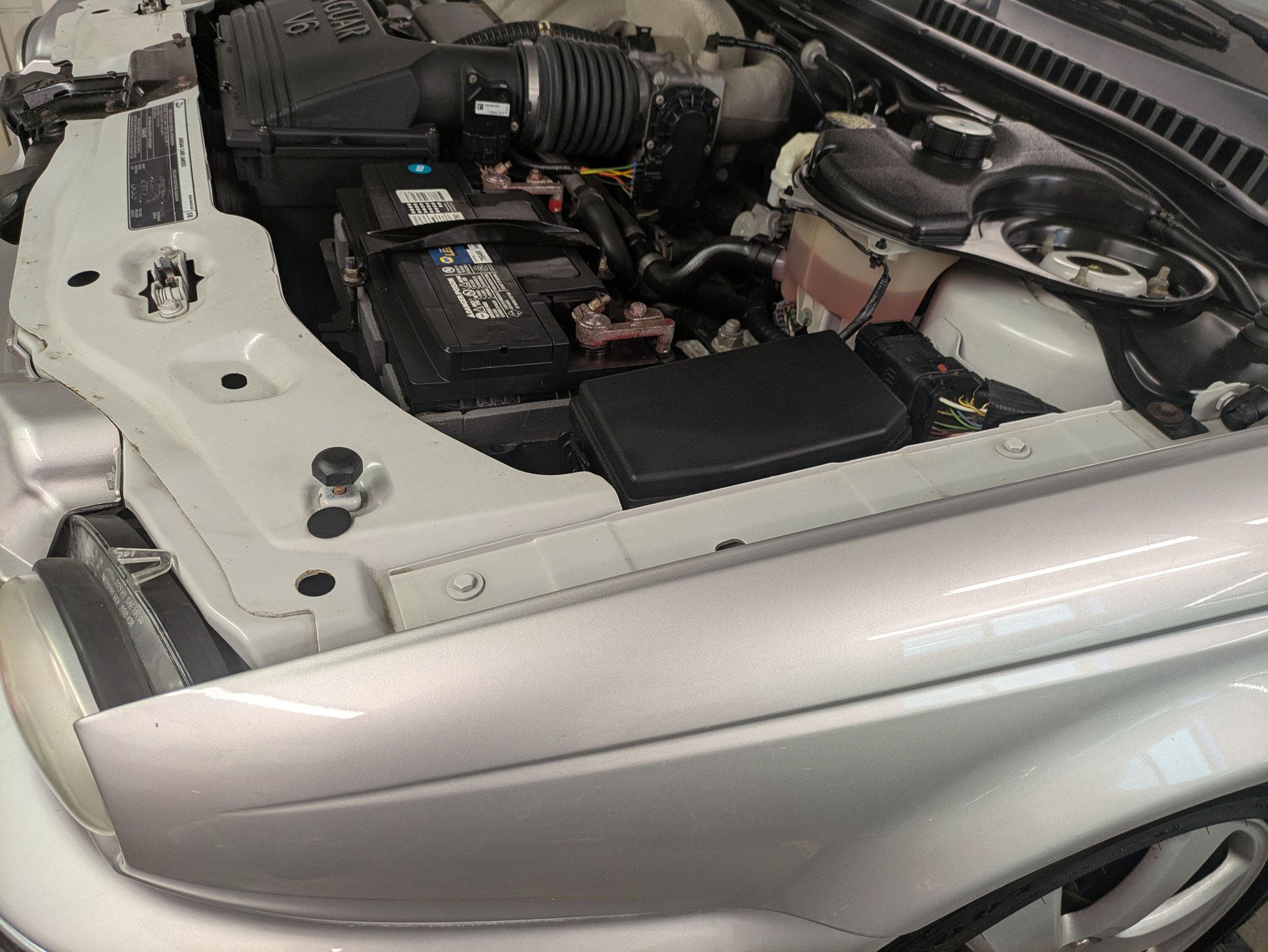

I just bought a car that is white everywhere under-hood, but the car is silver. All stickers are in place. I thought at first it might have had a front clip replaced at the body shop, but it looks like Jag just made it this way? I thought the whole body was dipped in paint at the factory?
