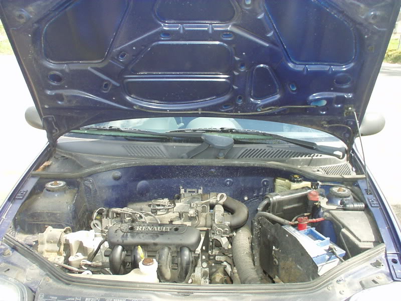

Here's an old before and after we did on Peter's little Clio using the same method
Before...

A simple spray bottle of APC (All purpose cleaner ) rags, a 2" paintbrush, some fairy liquid / Dawn and some wet n black ( tyre black dressing or similar ) and you're good to go
Simply use the spray bottle to dampen the affect area
Use your brush dipped in hot water with a fritz of fairy liquid etc and work away.....the brush bristles get into all those little nooks n crannies , another spray from the APC and then wipe clean
Makes sense to start with the underside of the bonnet and bonnet liner, then the deepest recesses of the engine bay you want cleaned, finally cleaning the engine cover and bay area itself
Afterwards a spray of your chosen tyre dressing type product and a final wipe down will accomplish so much more.
You can be as quick or as thorough as you choose and the costs cheap / result good
