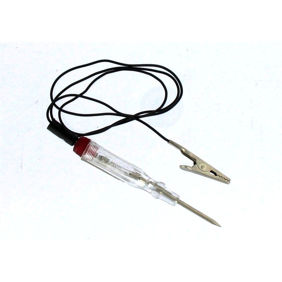

The easiest way to check if the relay is playing up, is to buy a new one and swap it. No harm in having a spare to hand anyway.
If you haven't got a test light, get a cheap one like this - it makes checking fuses easy:-
