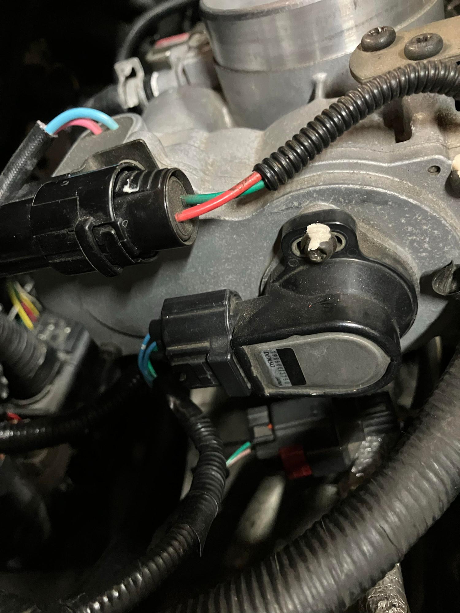

unplug the throttle motor. it’ll be declutched at default position and mechanically connected via limp home lever

should it idle better when I unplug the TPS on the throttle body?

which plug do I pull on the TB?
started up and even worse now, difficult to increase to steady rpm above 2000
I disconnected the MAF and it is much better, but still drops idle to 600 and gets rough
there is a whine coming from the engine TB area with key on, what is that?

The connector for the throttle motor is the one in your post #8 pic with the green and red wires.
My TB makes a noise from the throttle motor with the ignition on, although it's more of a buzz than a whine.

I unpluged that red/green connector and MAF disconnected. rough idle up and down 900-1200. FAILSAFE ENGINE MODE
Reconnected MAF. rough idle around 700 FAILSAFE ENGINE MODE

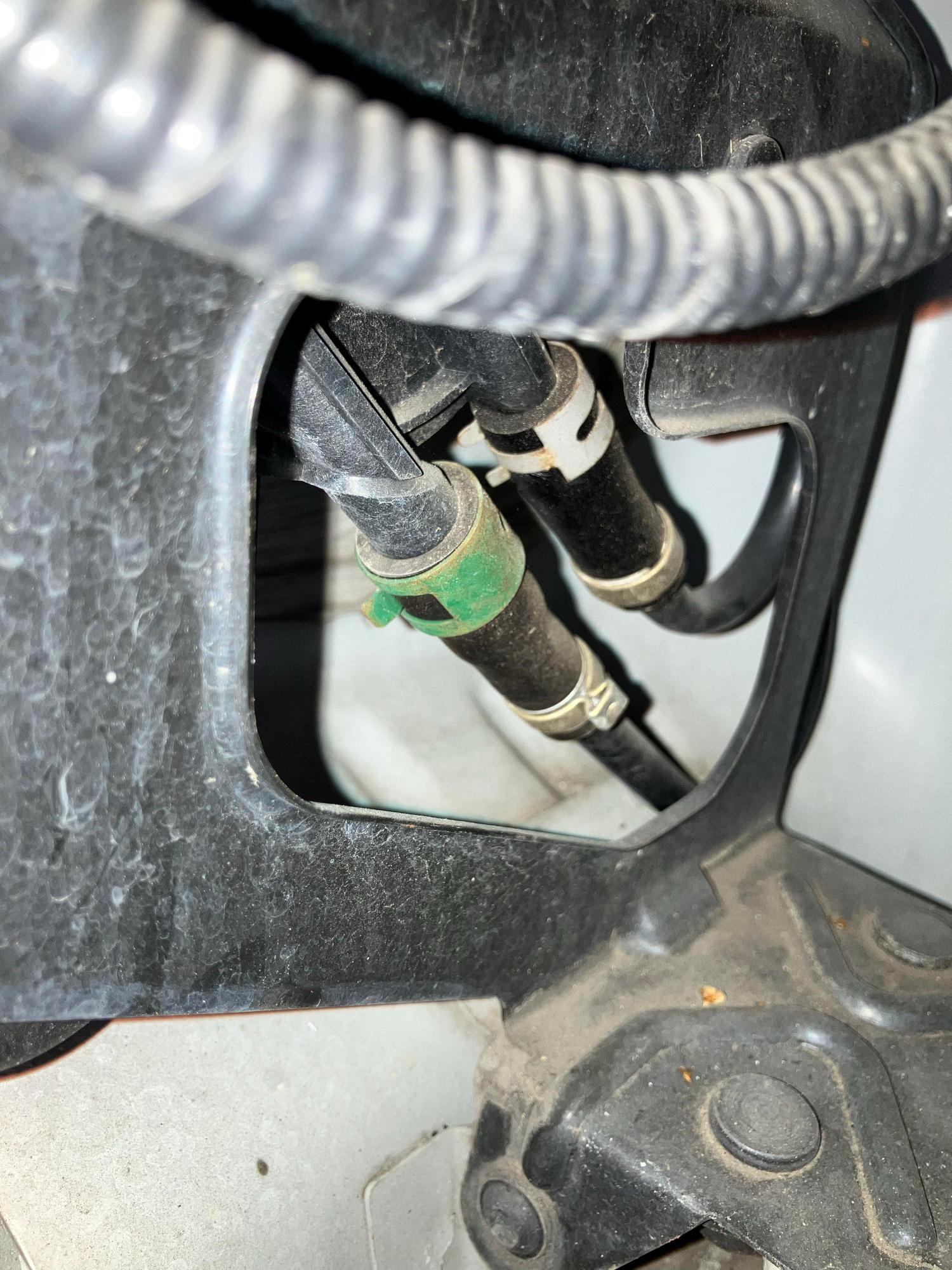

maybe it is the purge valve. and a YouTube says I can check the function of the valve by disconnecting line to charcoal cannister
which line goes to the canister. ?

anyone know where the canister is located on MY2002 xk8

I taped off the hose to the TB from the purge valve and still rough idle and stalling. I continue to smell gas fumes around the car, the car is running fuel rich?
It's underneath the left front fender liner, at the back. You'll need to remove the wheel and fender liner.
