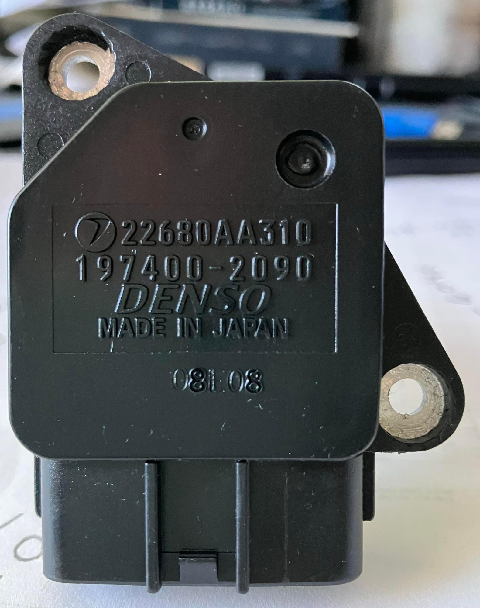

Originally Posted by zray
tbsts the same MAF some ebayer tried to sell me as correct for a 4.0 XKR..
not. And not correct for your XK8 either.
Z
the ad on eBay that I used was a classic bait and switch. The text / description displayed the correct Denso part number.. what I received was the MAF shown here
I believe the Denso MAF used on the 4.0 XK8’s is also used a several Mazda models. That’s what I recall reading on this forum.
Z

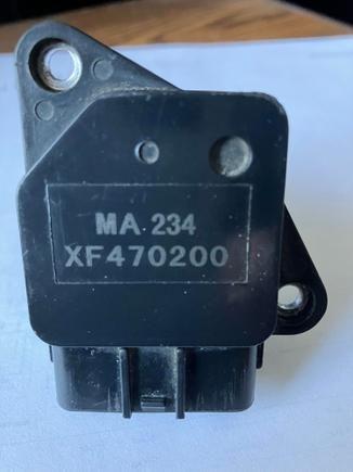

I ordered DENSO 197-6040
Box is noted as such, part is not
Can anyone cross reference. Usual used part has 197408-0010

Old Sep 5, 2025 | 05:16 PM
  #66
stevepaa's Avatar
Joined: Mar 2010
Posts: 904
Likes: 185
From: san jose
https://www.kmotorshop.com/en/articl...2w93-12b579-ab
says they are same
