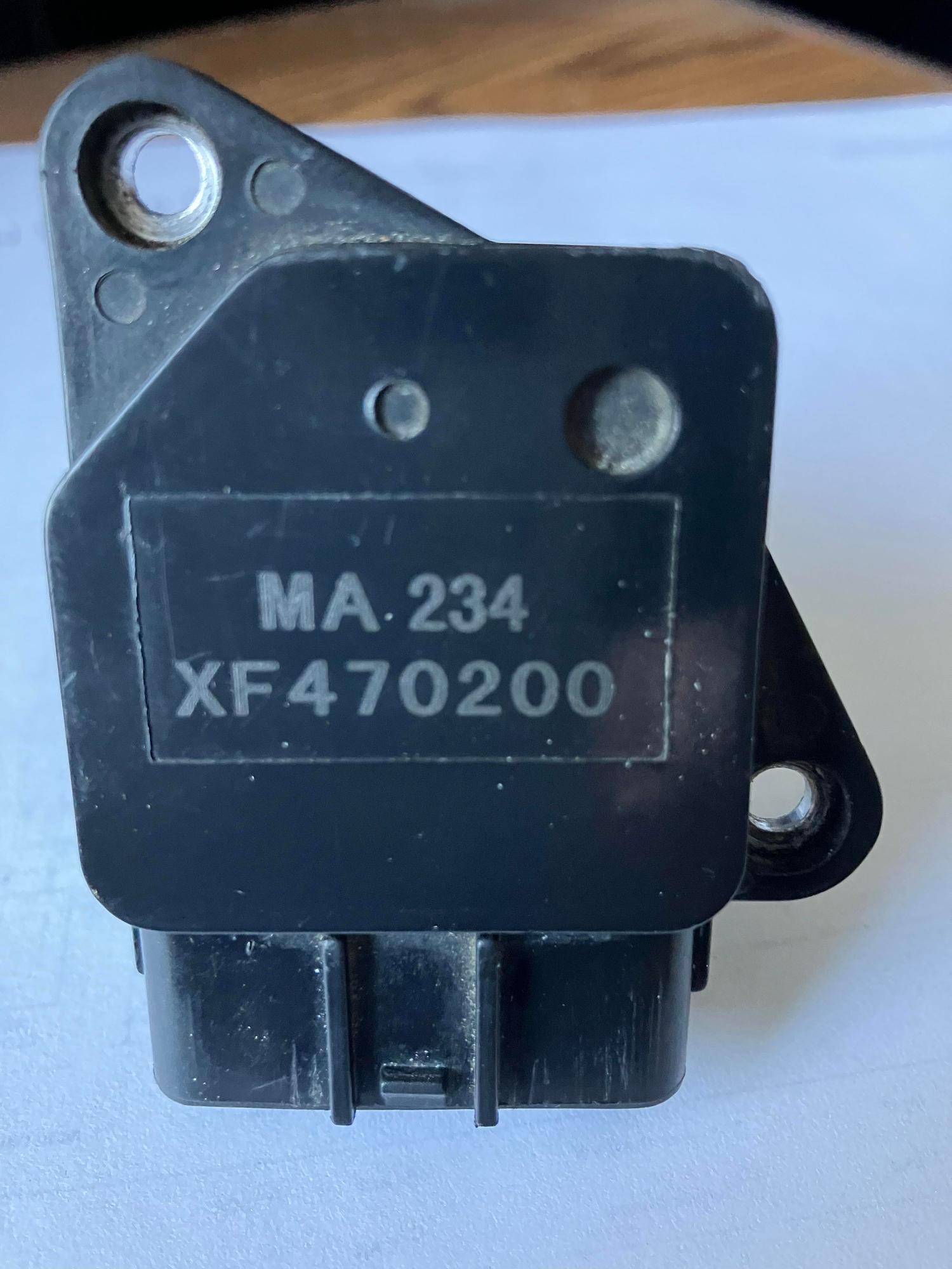

this MAF does not have typical DENSO part number
Old Aug 28, 2025 | 12:42 PM
  #51
Y2KJag's Avatar
Joined: Jun 2023
Posts: 683
Likes: 343
From: La Habra
That looks specious. I think I'd replace it, if only on general principles.

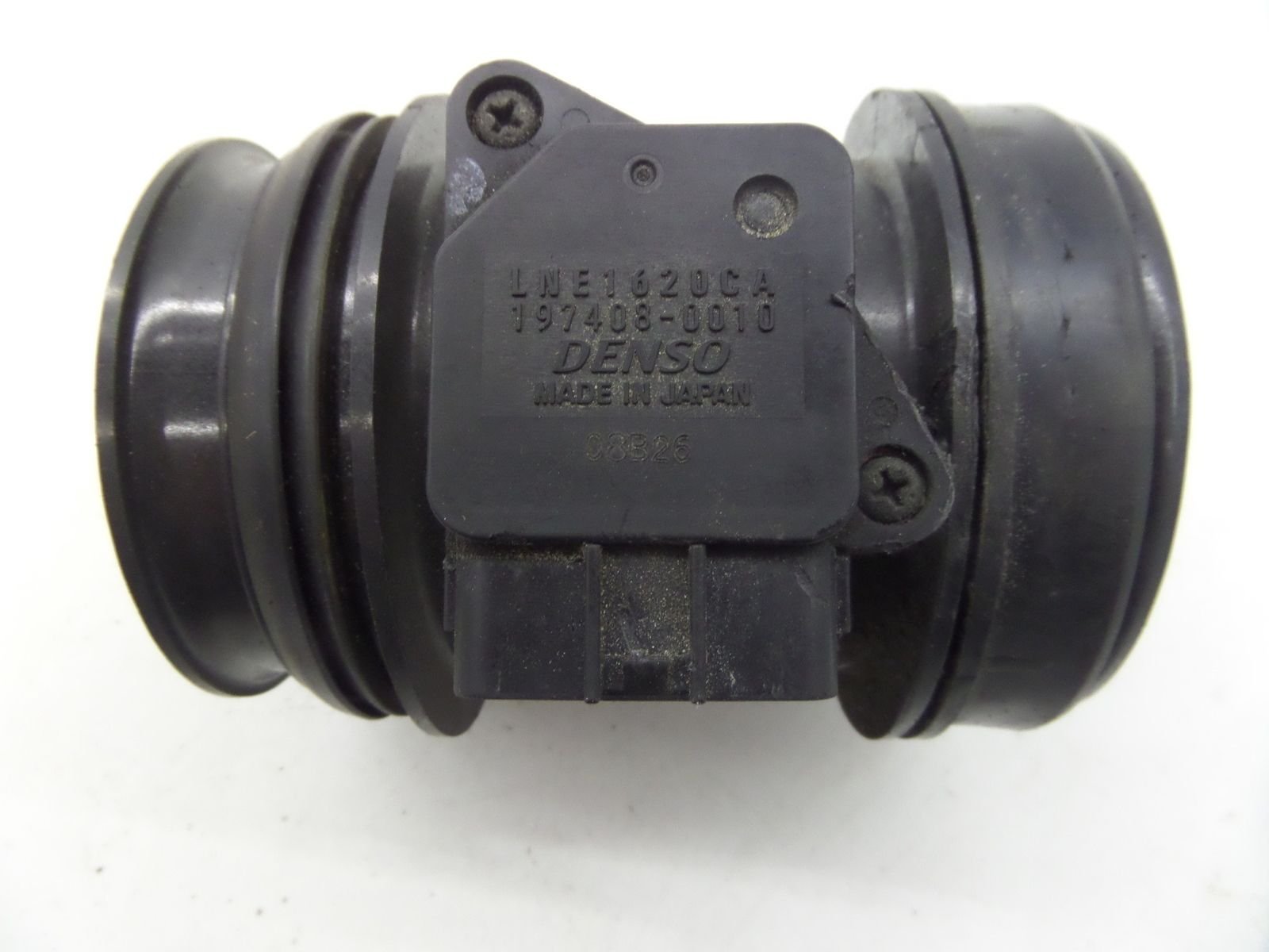

used part on Ebay has a different Denso number
Old Aug 28, 2025 | 06:21 PM
  #56
michaelh's Avatar
Posts: 4,822
Likes: 3,045
From: Jersey, Channel Islands
LNE1620CA has been superseded by LNE1620CB, so it's an older part (although it may still be working OK?).:
https://parts.jaguarlandroverclassic...ow-sensor.html
See this post from scottatl:
https://www.jaguarforums.com/forum/x...5/#post2122497
