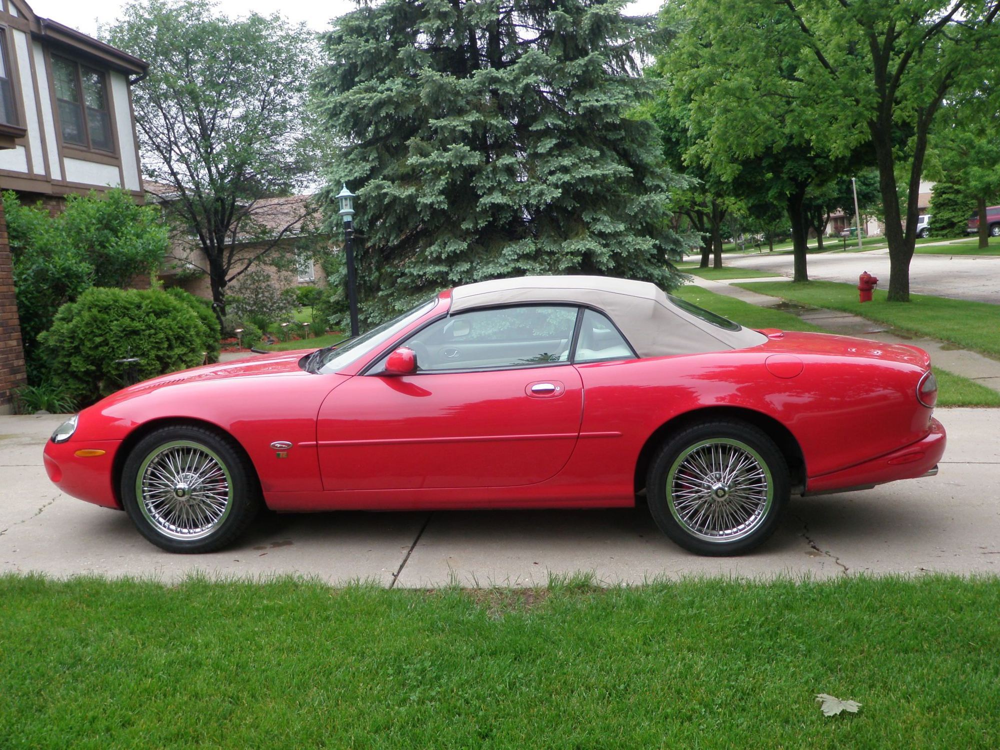

I have a blown head gasket or cracked head - what to do? R&R replacement engine? Cost of replacement? Lincoln engine same? Have repaired? Hours needed @ shop rate? It's a good looking convertible with chrome wires, good top, leather 99K miles. Ran like a banshee.
Any experiences or advice?
