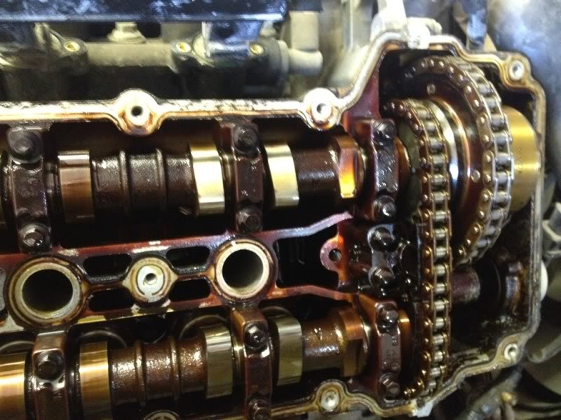

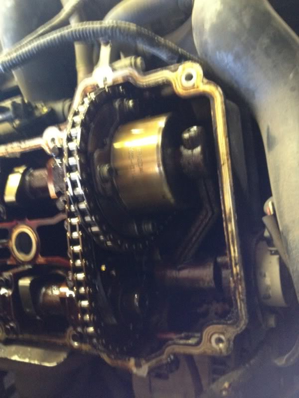

For some unknown reason, I started on the passenger side removing the valve cover. I was hoping it would be as clean as some of the other pictures I've seen on here... not so much. The one thing I can say is I know lubrication/oil flow isn't my problem...

It has obviously jumped time, notice that the flats on the cams (just behind the first bearing caps) are not aligned.

You may have escaped with new tensioners, which should be replaced anyway, and associated alignment of cam timing. Sorta got to do that before you can determine if there is further damage associated with a piston and valve attempting to occupy the same space at the same time.
Good luck.

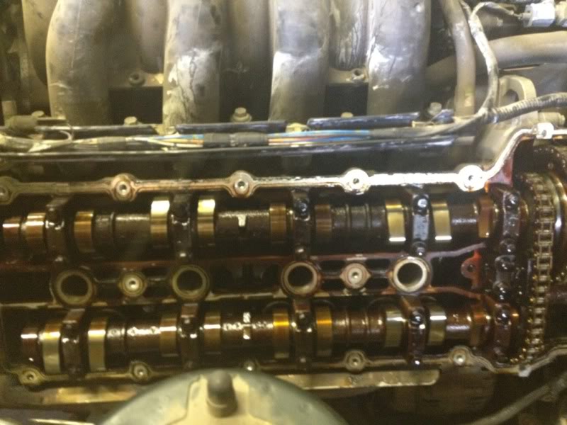

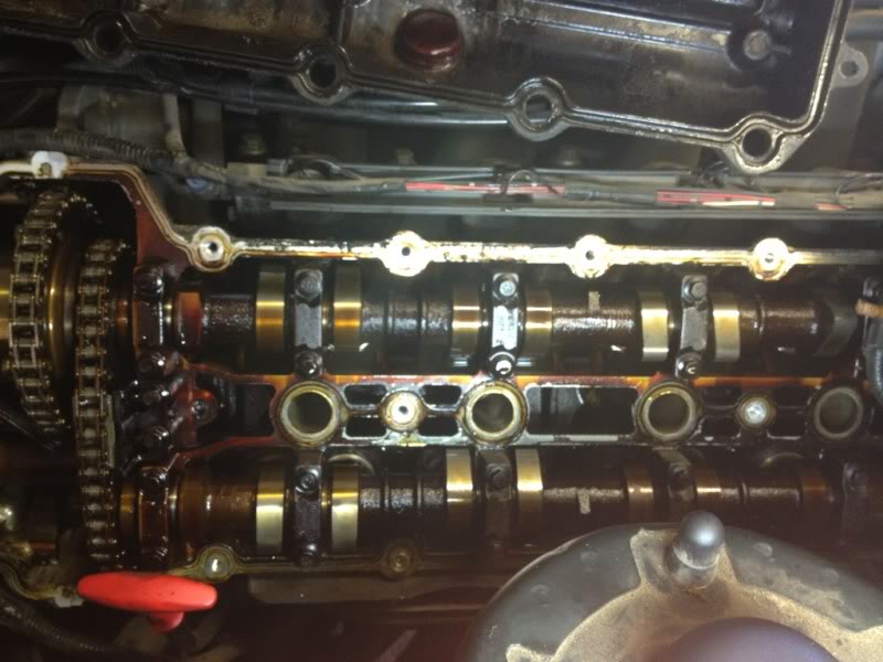

Here is the drivers side - please let me know if you see anything here that I might not have:

Thanks again for your help - truly appreciated. Regards,

Hard to be certain by the pics but I'd guess one tooth off. Search 'tensioners' to find out all you never knew you wanted to know about Jaguar cam timing and how to rectify your problem.

Jonny, your Left tensioner is missing it's shoe! The chain is riding on metal. I'll bet your Right one is in similar shape (the tensioner piston is on the bottom for the right side).

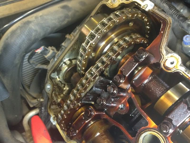

I am considering removing the valve covers to see if I have the old plastic timing chain tensioners, can anyone point out in the above pictures where you can see the tensioner?
A jag mech said you can see em from up top like this...
Old Mar 24, 2012 | 11:39 AM

Post #5, first two pics. Directly behind the chains you see six bolts in a row, parallel to the chains. The two center bolts retain the problematic, secondary tensioners. *'behind' means between the camera and the chains as the front of the engine is at the top of the pictures.*
