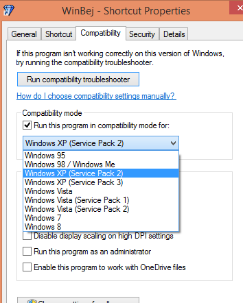

Guys, I don't use this software but see you're having issues with some latest version, I also don't know what ver of Windows you are running on, if nothing else there are some compatibility settings for programs I'm not sure you are aware of. Right click on icon and select properties you may see something like the pic below. I've had a few occasion I've needed to modify this setting for a older app (regardless of the new update). Kinda pulling at straws here
