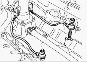

I wouldn't do anything else until pulling the ECU codes. A common cause of this light is a bad knock sensor. But there are others and until you have some idea as to the cause, you have no direction at correcting it.

My knock sensor produced a restricted performance and was hard to find.

Old Mar 2, 2010 | 06:13 PM
Gus's Avatar
Gus
Joined: Jul 2008
Posts: 11,356
Likes: 2,236
From: Berlin Md.
Is this what you are looking for?
