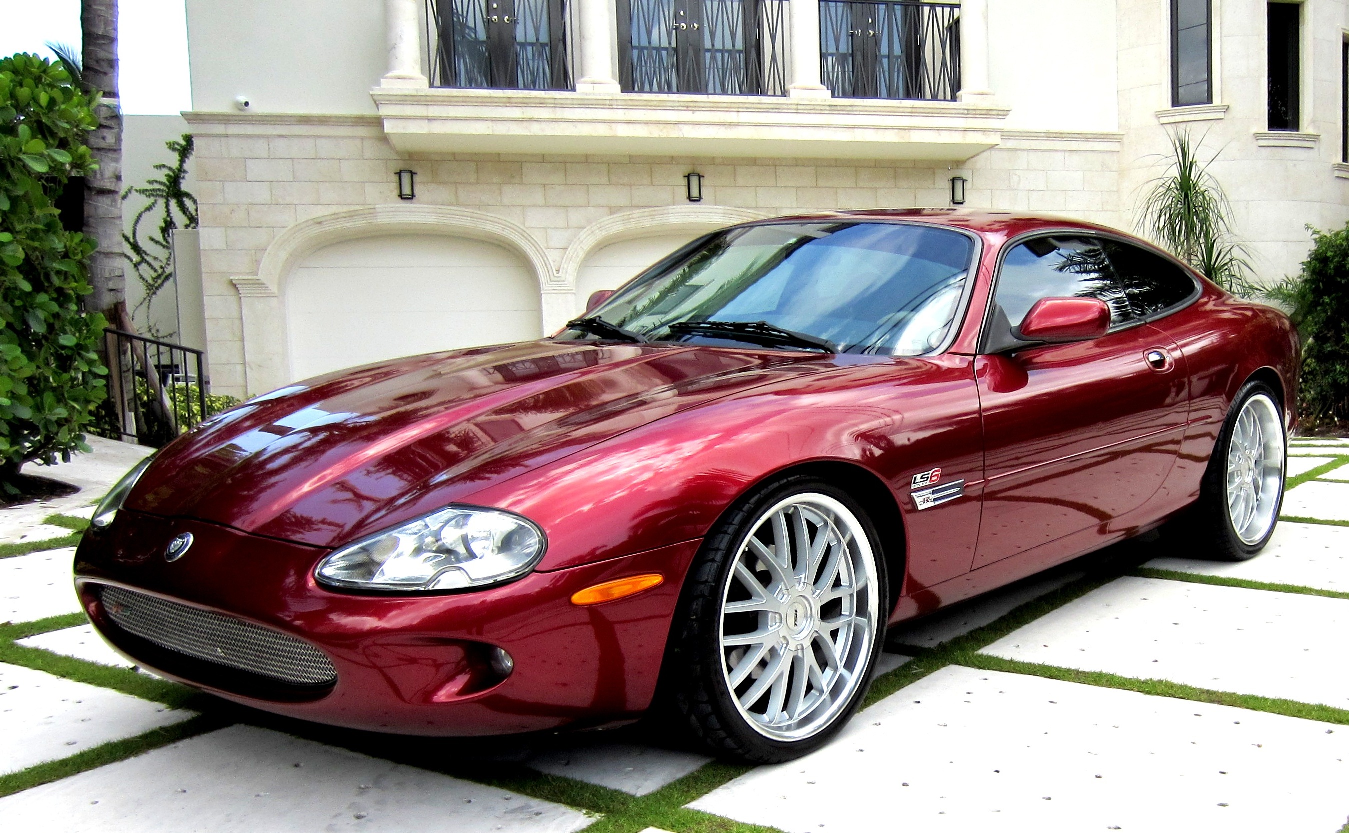

It's funny that you found that pic. The maroon XK8 in that pic is a 97 coupe owned by a customer of ours down in Florida. He had been a Jag (XJS convert) owner and Corvette (2000 LS1 powered coupe) owner for years when we connected. He liked the LS motor and came across this beautiful 97 coupe that needed mechanical help. With our kit, a spare LS1 (with LS6 cam and other upgrades) he put together the XK8 as you see it.
Fast forward to a year after the build- he sells the Corvette and XJS because neither of them to him is as great a car to drive and enjoy as the XK8.
And now, 4 years or so later, he has basically driven the wheels off that XK8, racking up some 50,000+ trouble free miles- it's his daily driver. He continues to do upgrades on the car and loves it (most recently he was upgrading to Brembo brakes- I wonder why?????)
Attached is a pic of the whole car now that you're already seen the engine.... (small hint there with the LS6 badge on the fender...)
