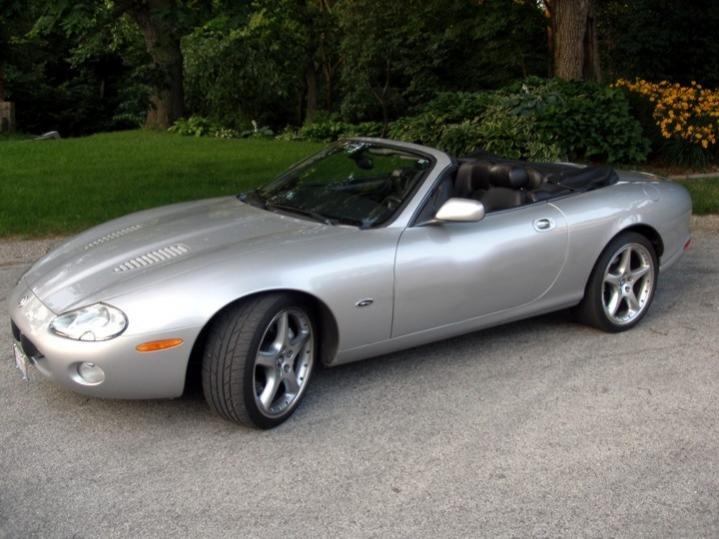

Ah!! It finally happened last night after dinner we went out and lowered the top and a small drop of green oil appeared out of the airbag sensor cover, on the upper console under the latch assembly. I ordered the hydraulic valve kit from LSI. But I was wondering which route to go on the hoses. Replace or splice? From reading the forums, splices may be questionable, or would the reduction in pressure from the hydraulic kit might even make them more reliable. How much longer, time wise would replacing the entire hose take compared to a splice. I have no problem as far as doing it myself,but I don't want to tie up my shop more than two days,(weekend). I would appreciate any opinions on this repair.

I just finished the hose repair and pressure relief valve installation this weekend. It took approximately 7 to 8 hours. The hose never blew out like the one in your photo. just a very small leak around the latch hose (which didn't make a mess). I was able to run the line under the carpet like you mention with out removing the door sill cover. The relief valve was a snap, a very simple installation. This should be a must do for all convertibles as easy as it is. I would like to Thank You and all the other contributors to this forum for the valuable information supplied.
