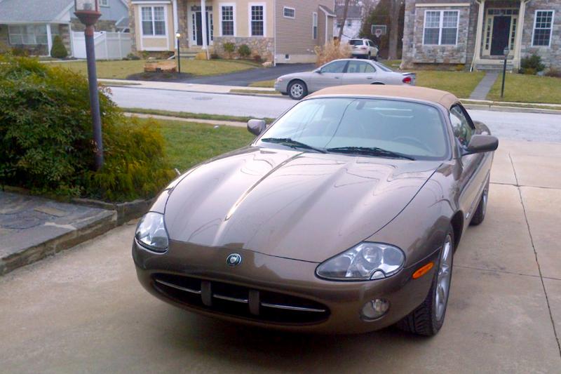

I hope the picture came through as an attachment.
Its to early to tell but I'm looking forward to getting the car into good shape.
I've been learning much from the information on the forum, and will find out Sunday (if its warm enough) if its just a small issue. More importantly I look forward to the Spring with the top down.
Mark

A rare sighting in this section - a Convertible with the top up.
Waiting for Spring? It's not raining, there's no snow on the ground and I can see a shadow under the vehicle. That counts as a Summer day where I live.
Looks good.

Yes top is up, 28 degrees outside snowed the next morning as well. Although I put it in the garage. Storage wise, is it better to leave to top up or down in the winter?
Old Feb 6, 2013 | 06:26 PM
Posts: 121,160
Likes: 6,655
I vote for up as it keeps the fabric taut and uncreased.

WhiteXKR's Avatar
Joined: Apr 2010
Posts: 7,657
Likes: 3,021
From: Arlington VA USA
Pretty care Mark! That bronze is a rare color, only available in 2001 if I recall. I know of one other member in AZ, Vettegood who also has one. Enjoy it!!

Very nice to see such a rare colour. Lovely car.
+1 on storage with the roof up.
