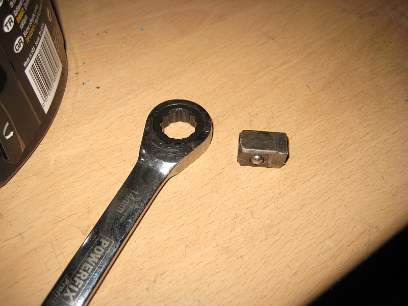

Originally Posted by weisberg
The rear diff fluid change does not look fun or efficient. Anything I should pass on to my mechanic?
He will need a tool like this below, see this thread https://www.jaguarforums.com/forum/x...iff-oil-71492/
Attached Thumbnails fluid change for supercharger and rear differential advised?-diff%2520filler%25202.jpg

next time i have the drain plug out, i'm going to epoxy a piece of 1/2" square bar stock into the drive recess of the drain plug
no more fiddling with adapters that drop out into the differential A frame
