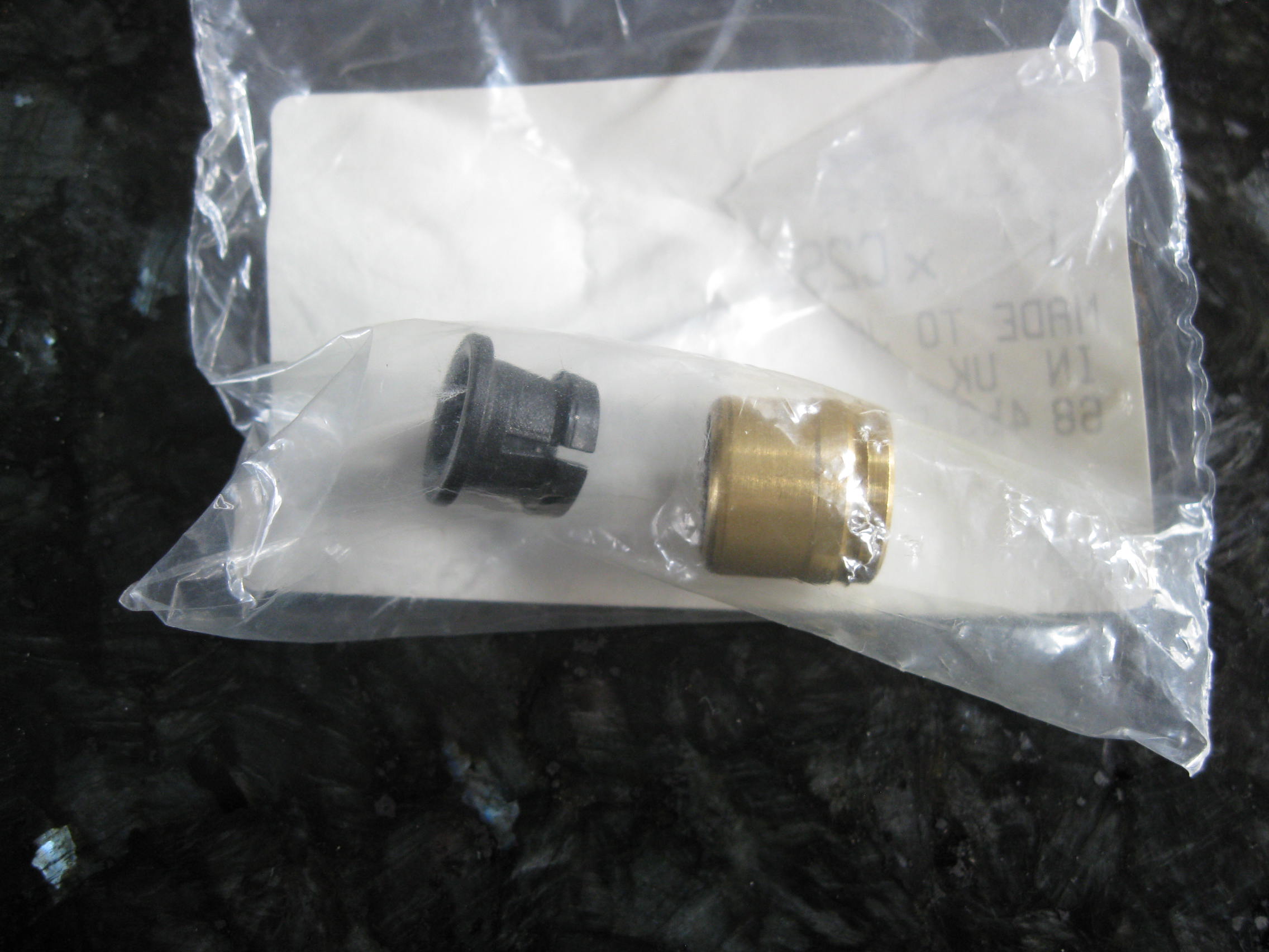

There is a hard plastic vacuum line that inserts into the lower passenger side of the throttle body with a plastic quick disconnect. One of the for retaining features on the clip was broken allowing air in. This clip is not obvious as it remains on the vacuum hose inside and asbestos and foil heat cover which you would have no reason to look at, and does not come out with the throttle body.
I took the vacuum line to the Jag dealer as I figured I probably had to order the whole line to get the clip. The dealer cannot figure out a part number for me and has sent pictures of to the UK to try and figure out a part number.
Meanwhile with an "O" ring and some sealing tape I have managed to put it back together. If I do get the part I can install it without removing the throttle body. Everything is running well now.

I had the very same problem with my 99. Use this link and scroll down near the end and you will see the connector.
Link JagRepair.com - Jaguar Repair Information Resource

See if this helps.

Photos of fitting
Attached Thumbnails Follow Up on Thermostat Housing Valley Hose Replacement-img_3086.jpg   Follow Up on Thermostat Housing Valley Hose Replacement-img_3087.jpg

Thank you for that information, even though that little fitting is $23 Canadian that is still better than $74 for a hose I don't need.

I got the fitting Gus suggested and it fit great. They do not list the P/N for the XK8 but they do for the brake vacuum Booster on an S-type. My Jag dealer parts guy is also an XK8 owner so he says he will salt that useful piece of information away for future use. I don't know how I would get along without the help of the people on this forum. Thanks again.
