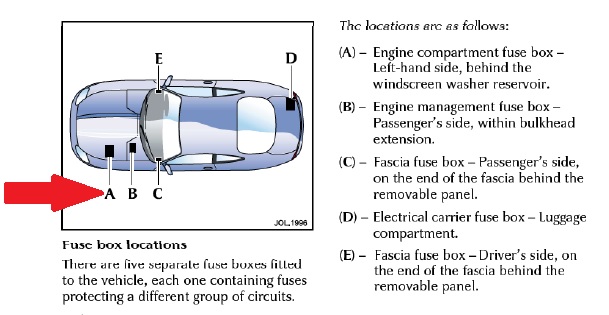

Have you located and checked the correct fuse?
The headlight fuses are in Fusebox A:
The RH low beam is Fuse #6 (20 amp):
