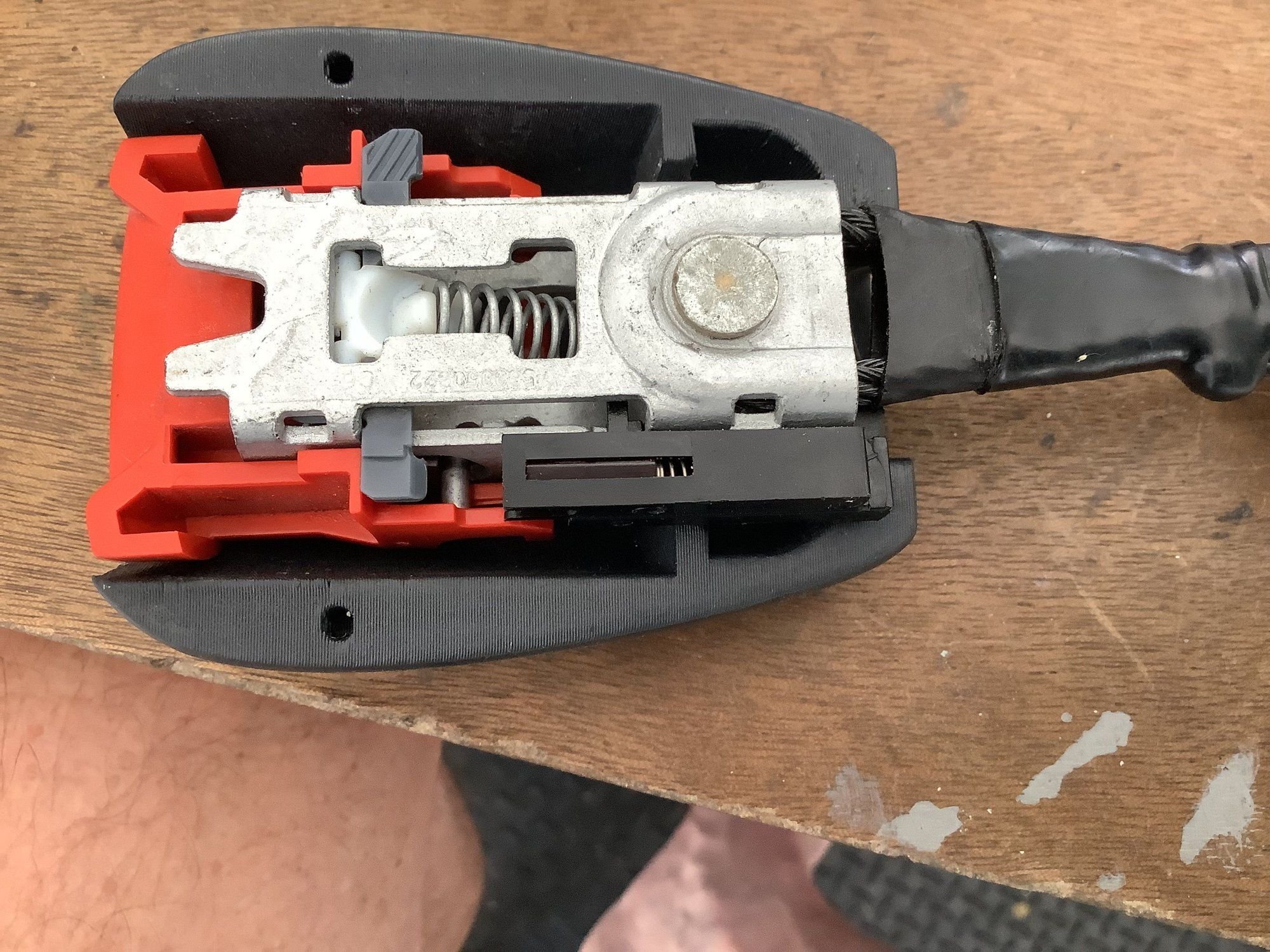

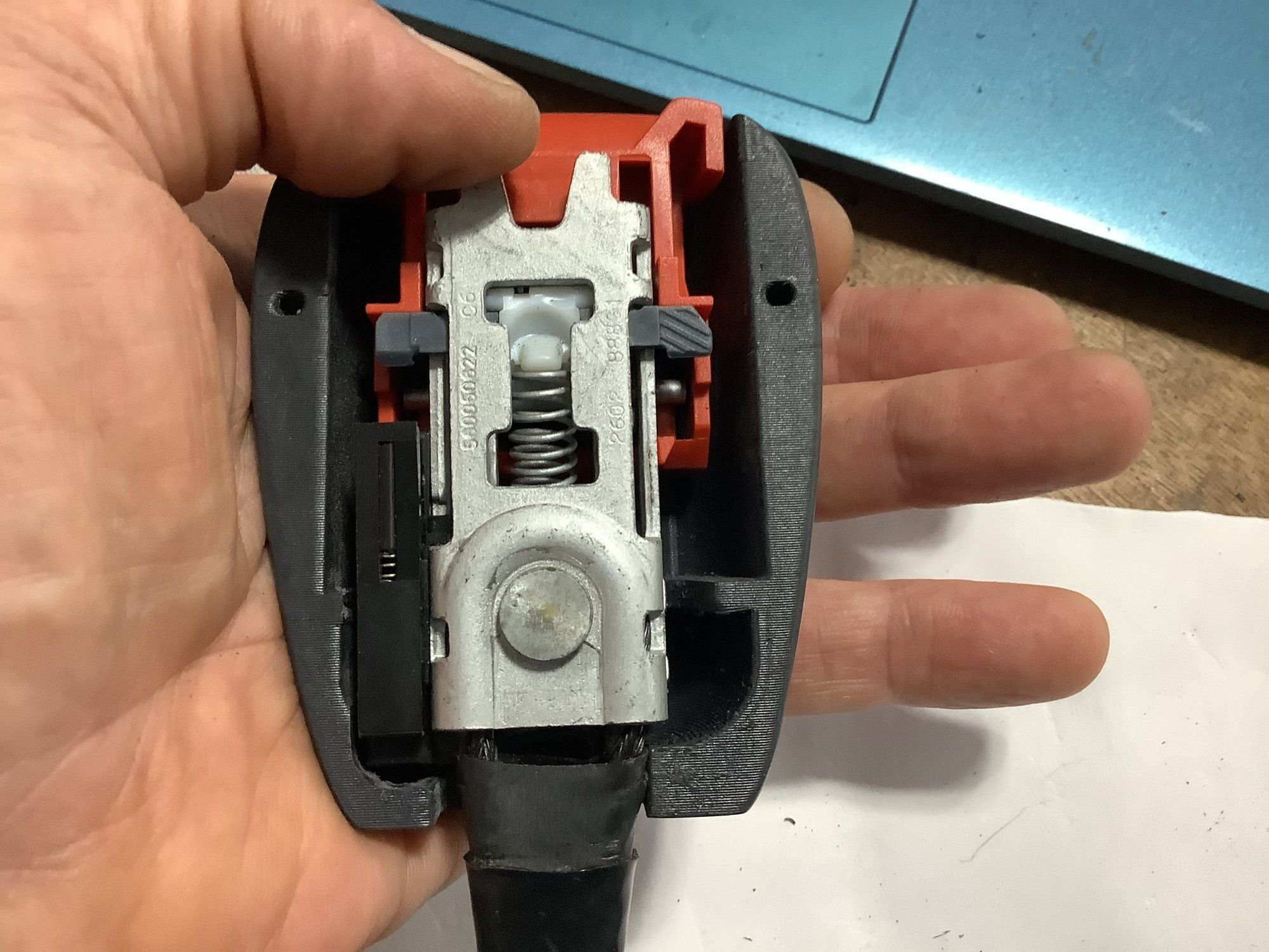

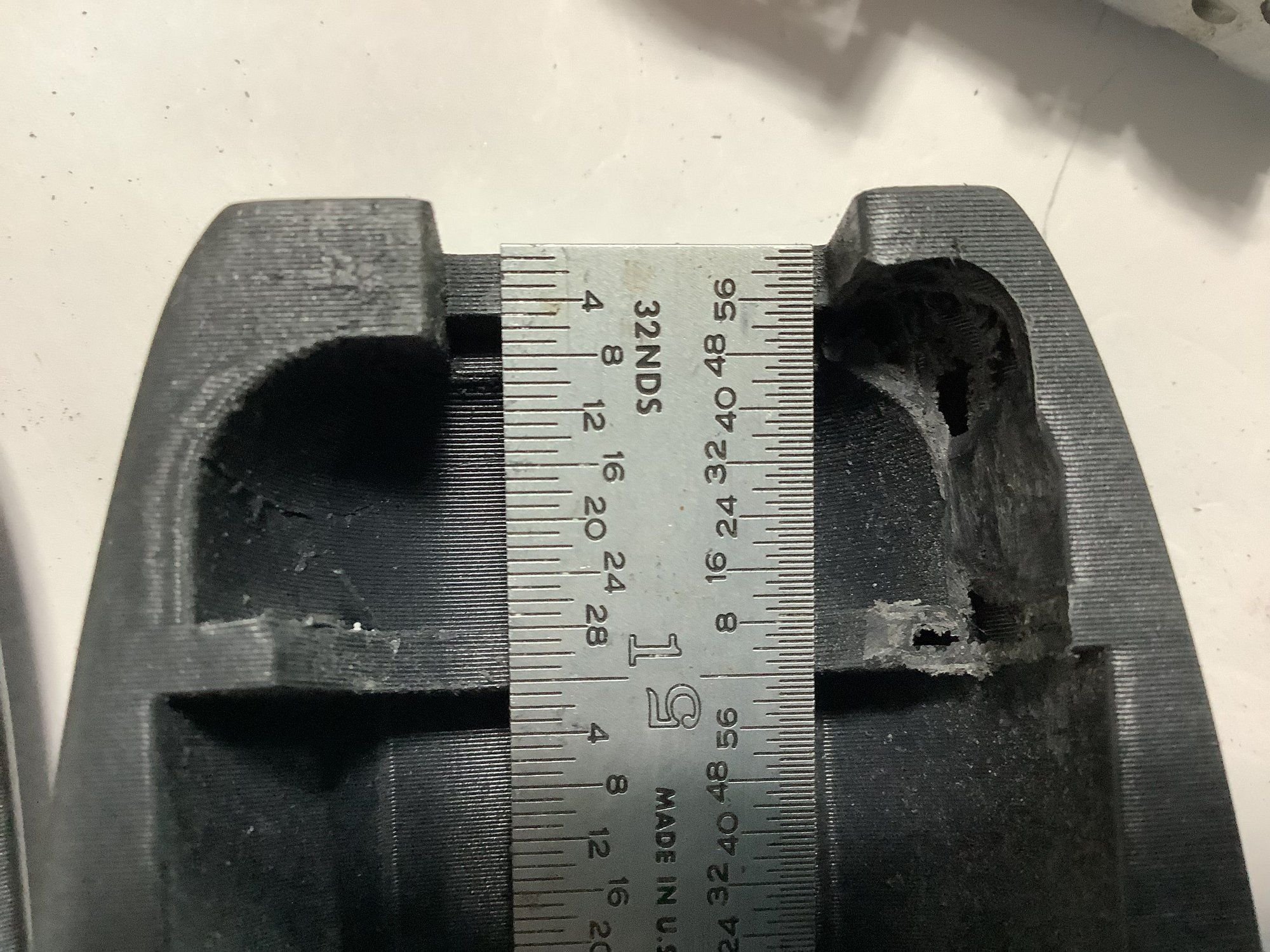

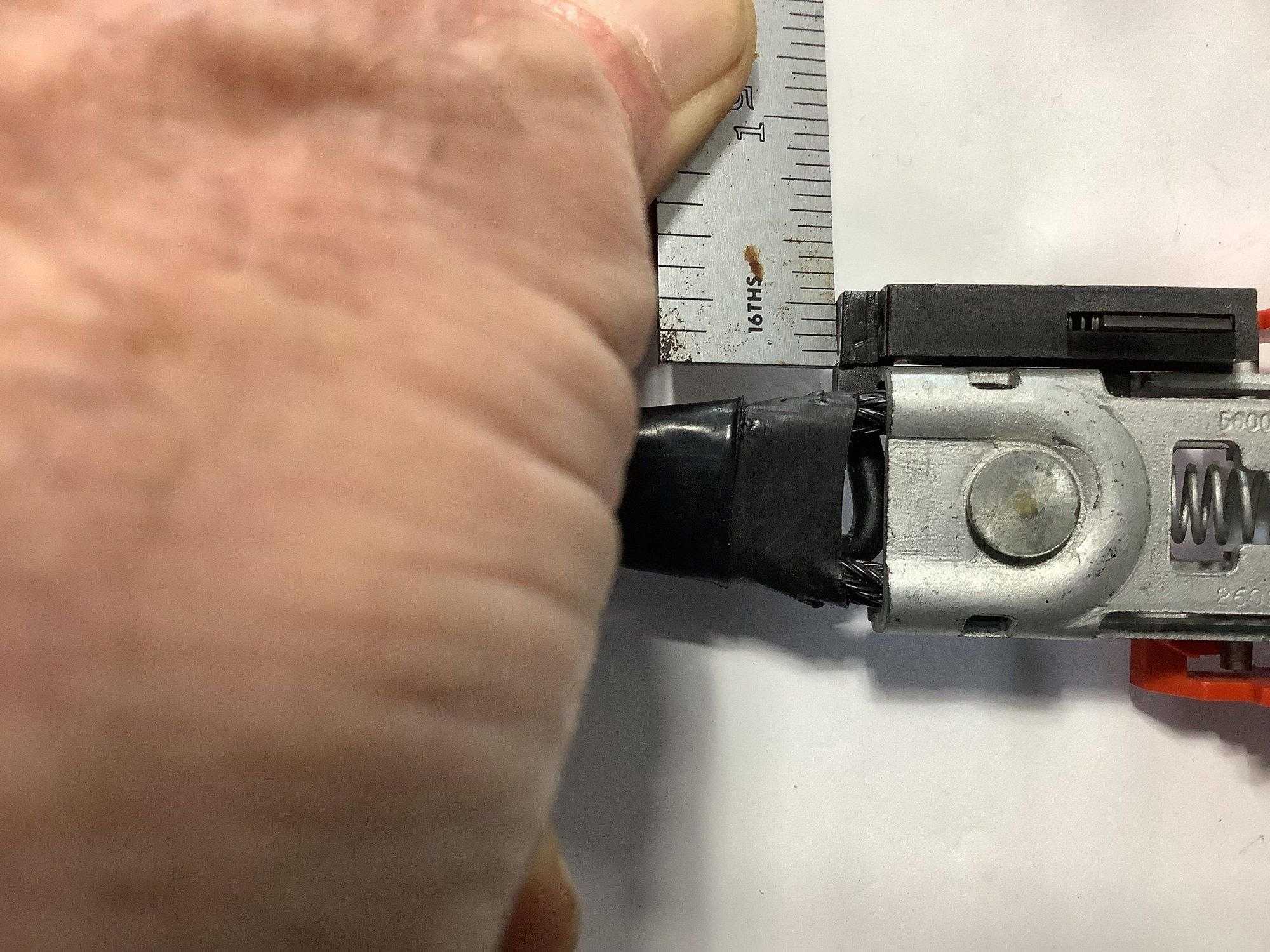

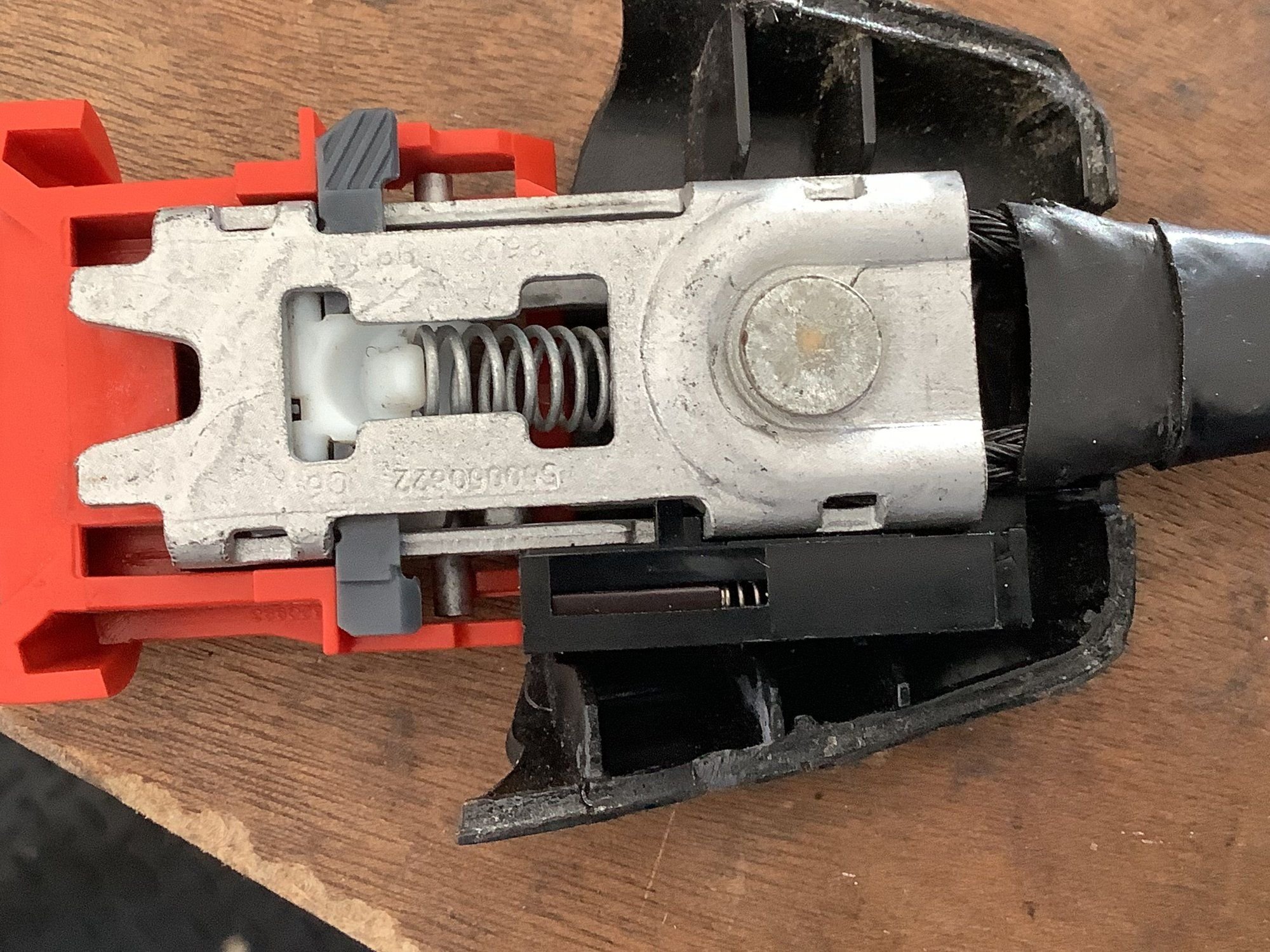

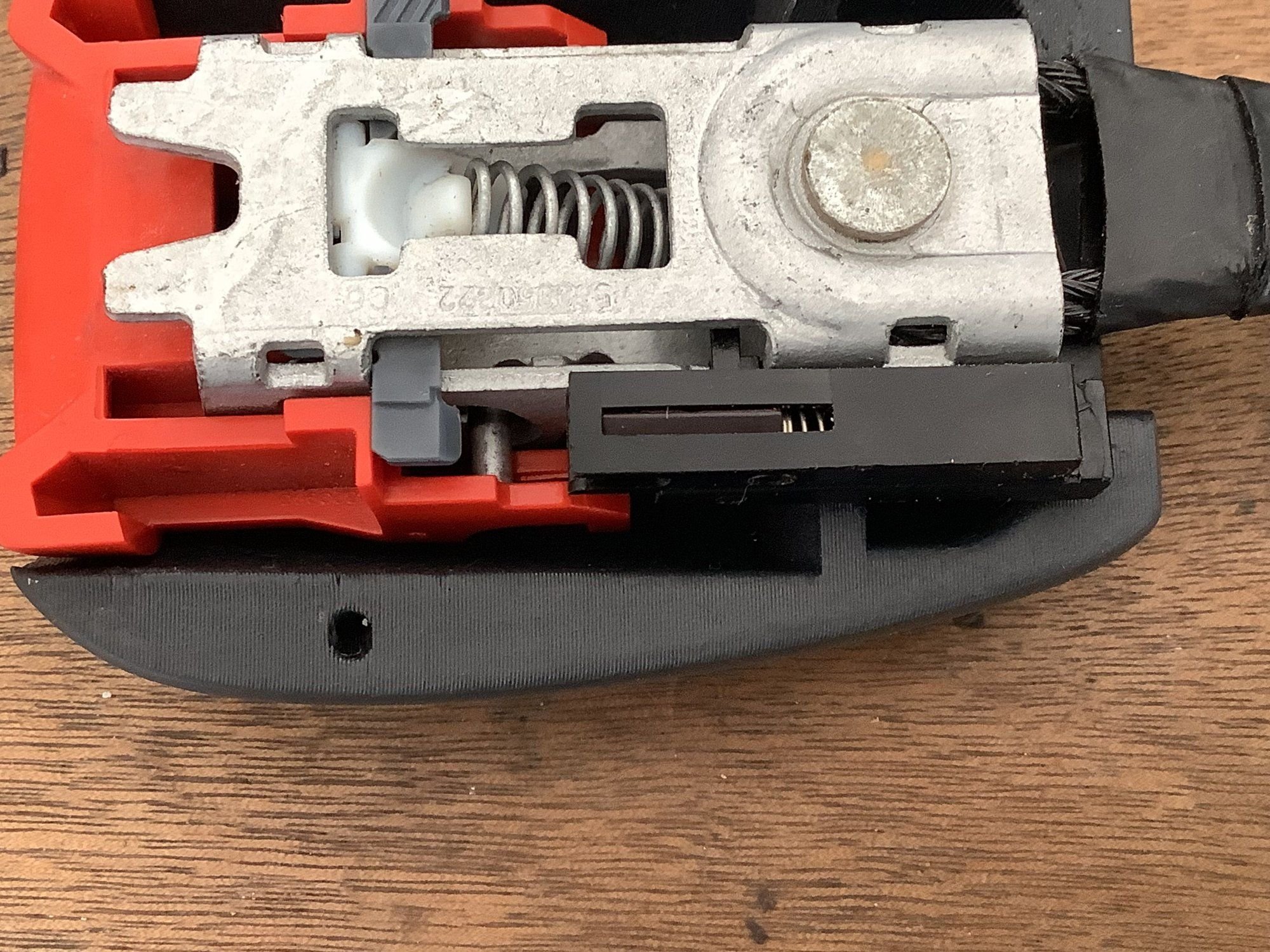

Hi guys! Important update. @Shoreguy has brought the following issue to my attention. On his car, there is a small sensor that is attached to the inner belt buckle assembly. For some reason this part is missing on mine, which means, if you have this sensor on your car, you will need to modify the part I sent you accordingly.
He will be letting me know how this modification works out for him. Until I hear back from him I will hold the parts I am preparing so that I can add the modifications accordingly before sending them to those of you who still have yet to receive theirs. I will also let the 3D printer guy know so that he can modify his CAD design accordingly for future prints.
Here is what Shoreguy sent me:
Originally Posted by Shoreguy
Hey Gian
Any suggestions what I’m doing wrong? Am I going to have to modify to fit?
Problem is the black sensor housing will not clear. And it seems the support cross piece is to high?
I replied to him that it seems that sensor is missing on my car, and thus he will have to modify his part. Which he did, and this is what he sent me:
​​​​​​​Hey Gian
The picture I sent you with the sensor was passenger side. I’m wondering if your passenger side is the same as mine?
Besides cutting the corner out for the sensor to fit I had to cut a relief hole for the sensor wire where it exits the back. Just for a better fit of the two halves I cut a recess on the bottom half for better alignment. Here’s some pictures it should work fine we’ll see.
Those of you that have already received the part, @Ledmi ​​​​​​​@Chirpy @Schrodinger's Cat @MsMaybe98 @dfbender, please modify accordingly or, if you are unable to do so, you can send back the part and I will modify it for you at no extra cost to you in shipping.

Hey all

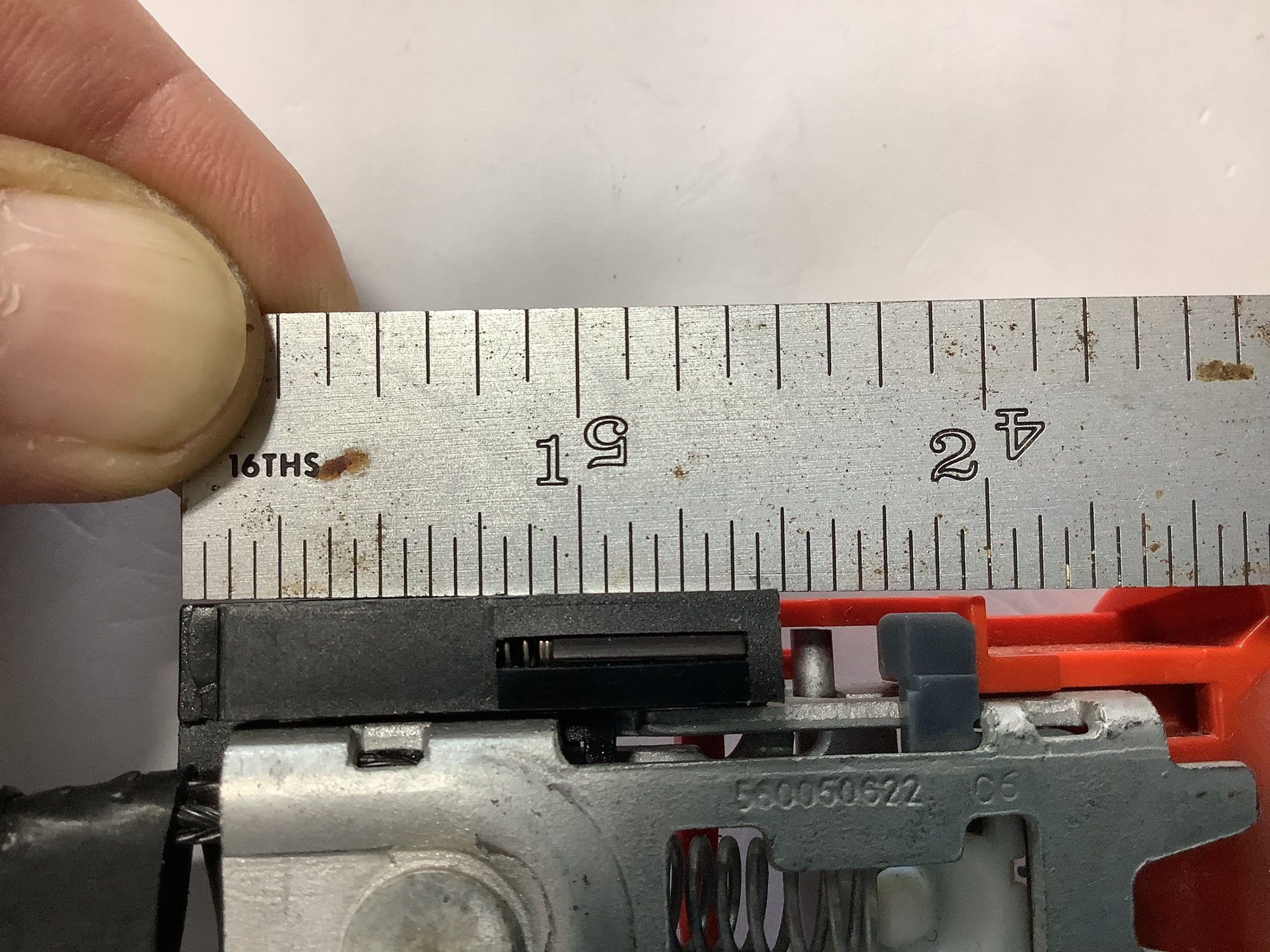

Look, these parts will obviously work and like most restorations and upgrades you may have to make some modifications and adjustments to make it work. Take your time and make it work they look great and is way way heavier duty than the original so you should never have to do it again. Yea!

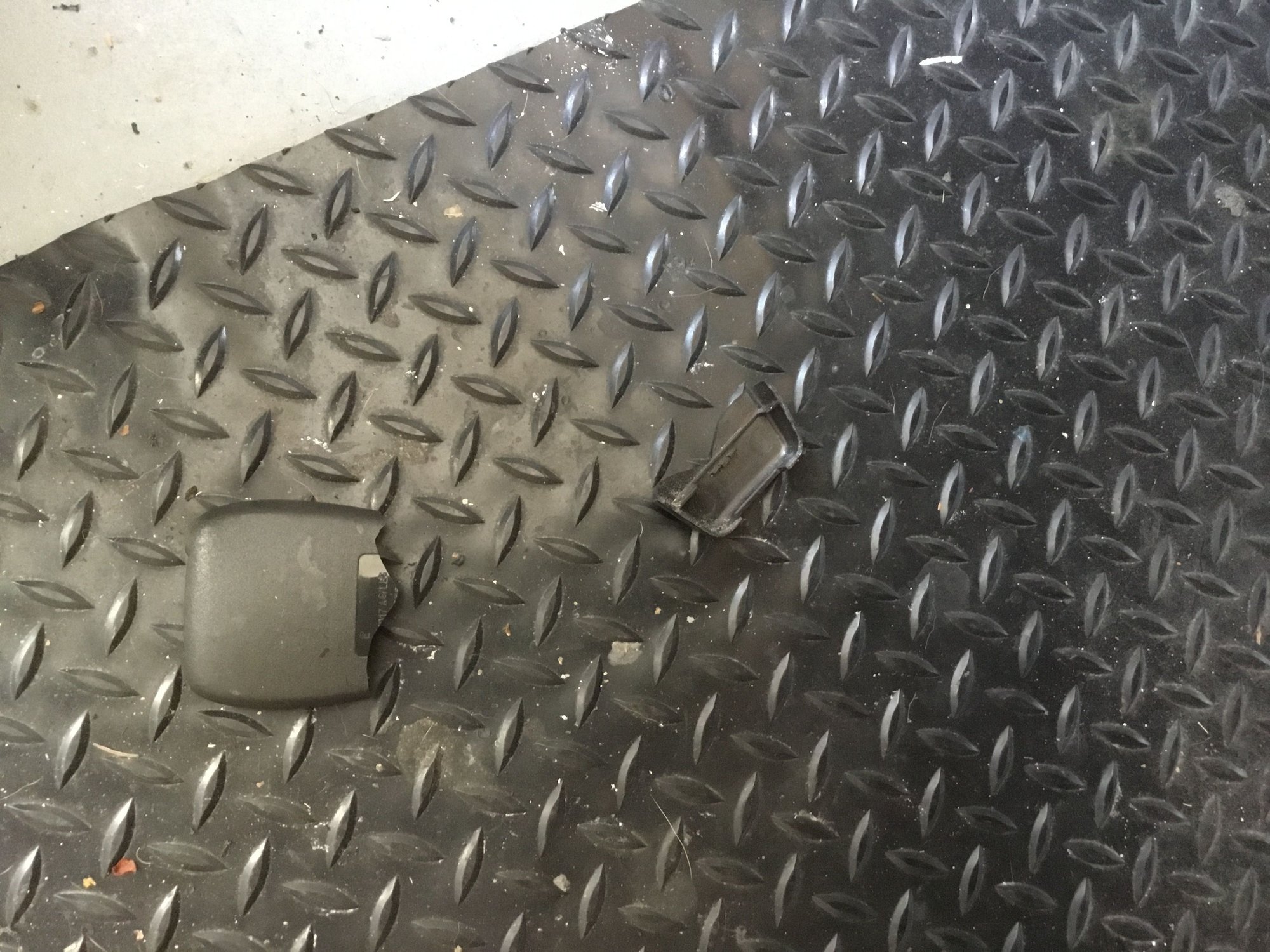

Sorry the above video was really quick.
Guess what? The only good half of my old buckle cover fell to the floor from my workbench and broke in half. lol
Good riddance lol

Thanks for your feedback! I'm glad the modifications you did worked out. I will be doing this modifications to the batch that I am in the process of preparing to ship.
Hahaha, ouch, I bet you're glad you already have the ones I sent to replace that. Those old buckle covers really were very fragile after the years of heat and UV baked them to brittleness. I wonder if when new they were more resilient?
Quick question, that ruler you used, is it calibrated in mm? Inches? Centimeters?

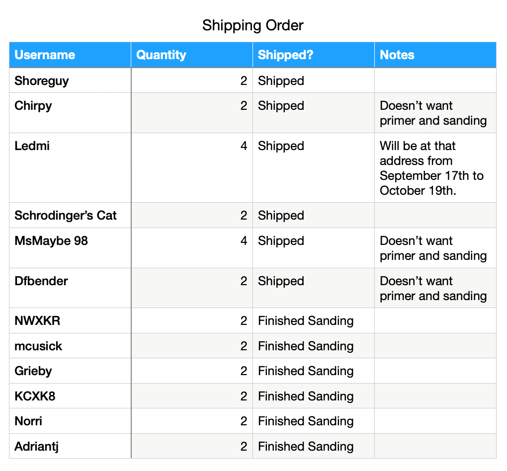

Hi guys, please forgive the delay. I have had a lot of school work these past few weeks and have had no time to prep the remaining buckles. I am prepping them today and tomorrow and will ship as many as possible on Monday.
Pertaining the new members interested in buckles. Please wait until I list them on ebay. I will not be sanding and priming future orders that will be sold via ebay for the foreseeable future as it takes too much time that I don't have as a periodontology resident.
Old Oct 26, 2024 | 05:55 PM
  #113
giandanielxk8's Avatar
Posts: 3,773
Likes: 1,644
From: Puerto Rico
I finished sanding all of the pending orders today. Tomorrow I will do the modification that was detailed by Shoreguy and then I will prime all of them. They should be ready to ship by Monday or Tuesday.

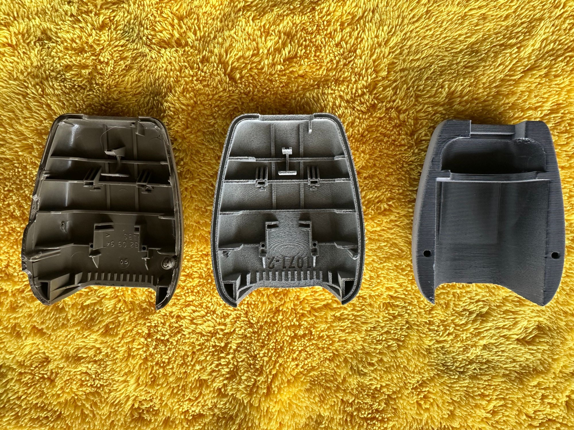

Default These vs original vs octoclassic
Before I was aware of these, I purchased a set (not cheap) from Octoclassic out of Poland. This photo shows my brown original on the far left, the octoclassic in the middle and these on the right. You can see how much more sturdy these are. And the octoclassic feel as cheap and brittle as the original. And you can take these on and off with screws. I’ve got to dremel a bit on mine for the black sensor that I have.
