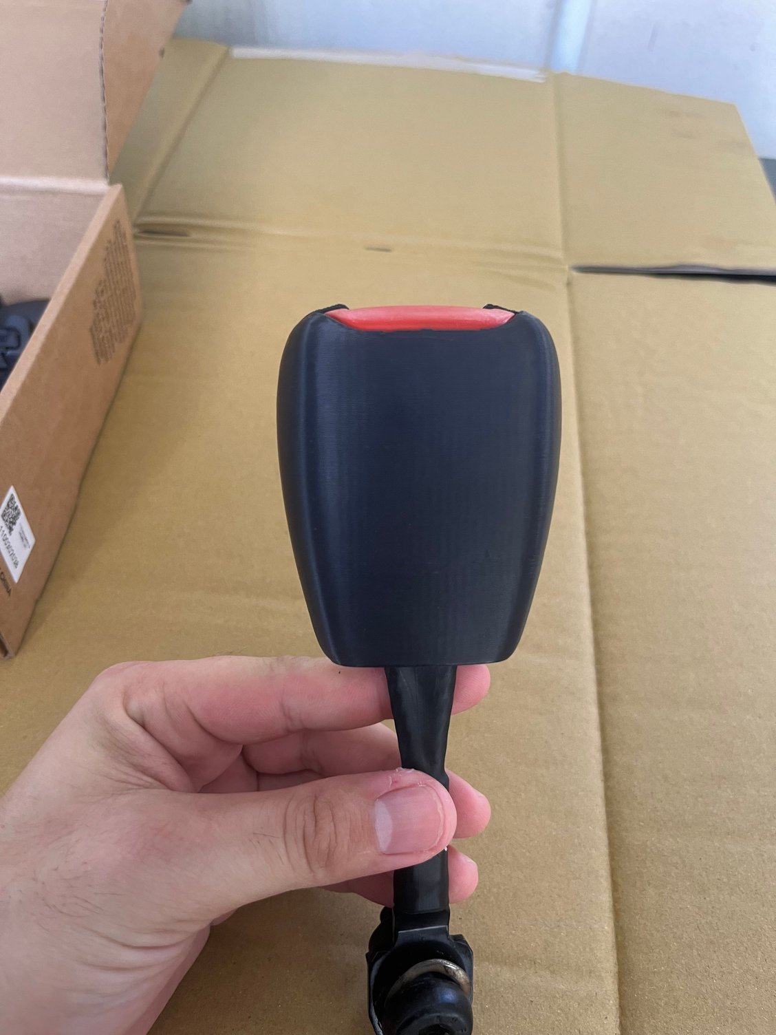

He printed the final part today and it looks great.
I will be picking it up on Thursday to try it out on my car.

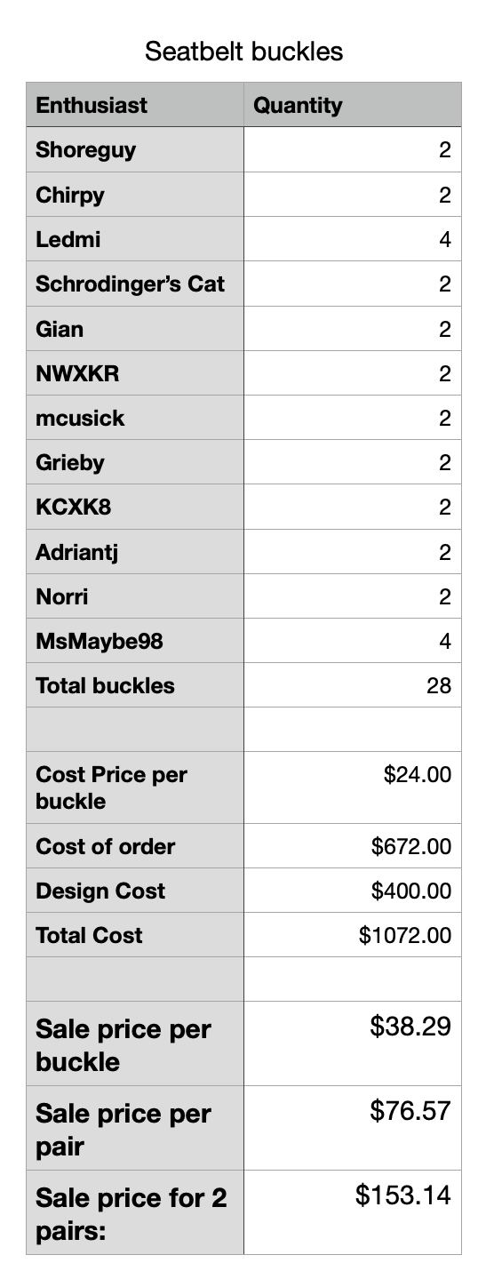

I picked up the parts yesterday, but have not had the opportunity to test them. He gave me a few units to practice sanding and using primer. Tomorrow I'll go buy the sandpaper and primer to give it a try. After that I will proceed with asking him to make the batch. When I begin shipping, I will do so according to the order of the following list:
  1. Shoreguy
  2. Chirpy
  3. Ledmi
  4. Schrodinger’s Cat
  5. NWXKR
  6. mcusick
  7. Grieby
  8. KCXK8
  9. Adriantj
  10. Norri
  11. MsMaybe98
This list comprises the batch I will order from him. Twenty-eight buckles in total. Sale price per part will be $38.29 per buckle. A pair would be $76.57. Those who want 4, will pay $153.14. I'd like to stress that I have not calculated these prices to make a profit off of this, but rather to break-even with what the endeavor has cost me. After this initial batch is shipped to everyone, I will begin selling them on ebay, for a modest profit. You may begin pm'ing me with your shipping addresses. Payment can be either Paypal, Apple Pay, or Venmo. If you require any other payment method, we can arrange something.
One last thing I want to remind you. This part is not an identical clone of the original part. It has been reinforced in some areas, the plastic being used is ASA rather than ABS. ASA is a more UV resistant and overall stronger plastic than the ABS Jaguar used. This part is screw-retained rather than press fit like the OE Jaguar part. The screws will be supplied. This means that if you want to take it apart, you can do so to your heart's content, without fear of breaking it. I will be shipping them all primed, and ready to paint. Even those who need charcoal ones. The charcoal interior does not match the black ASA plastic, although it comes close. But I do have to sand them to erase the lines of the printing layer. A light scuff and filler primer is all that is needed.
This is the spreadsheet I used to calculate the price

You're lucky it's labor day weekend, which means I can add more people to the order until Tuesday. I'll put you down for 2.
Adding you brings the price for everyone a tiny bit more:

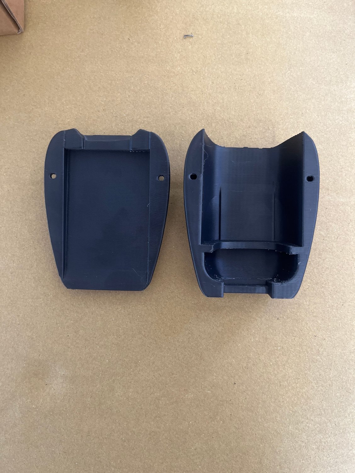

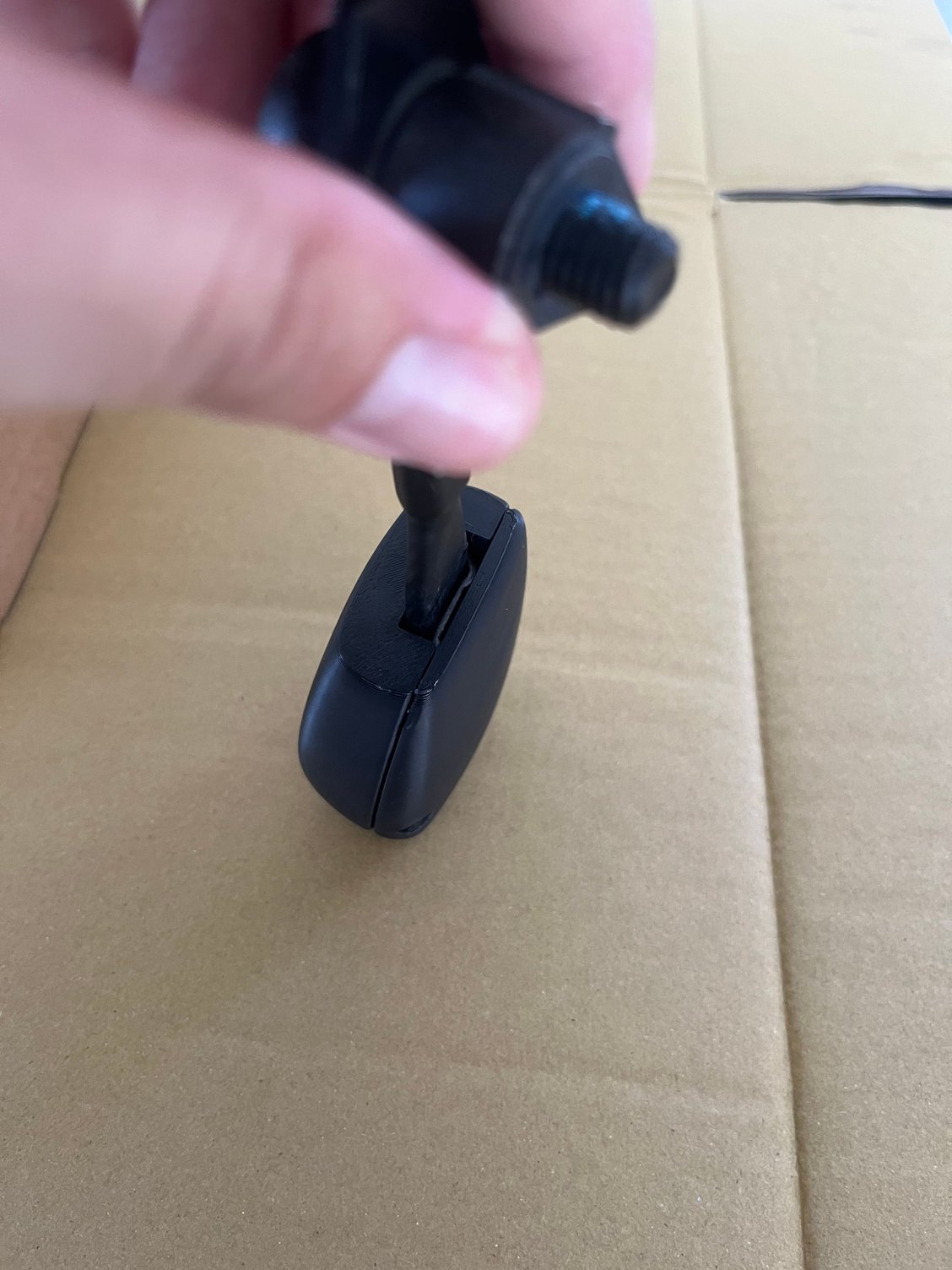

As promised, here are pictures of the parts prior to sanding and priming. I will only be sanding and priming the external surfaces. The internal surfaces will not be primed to avoid thickening it and causing it to bind.

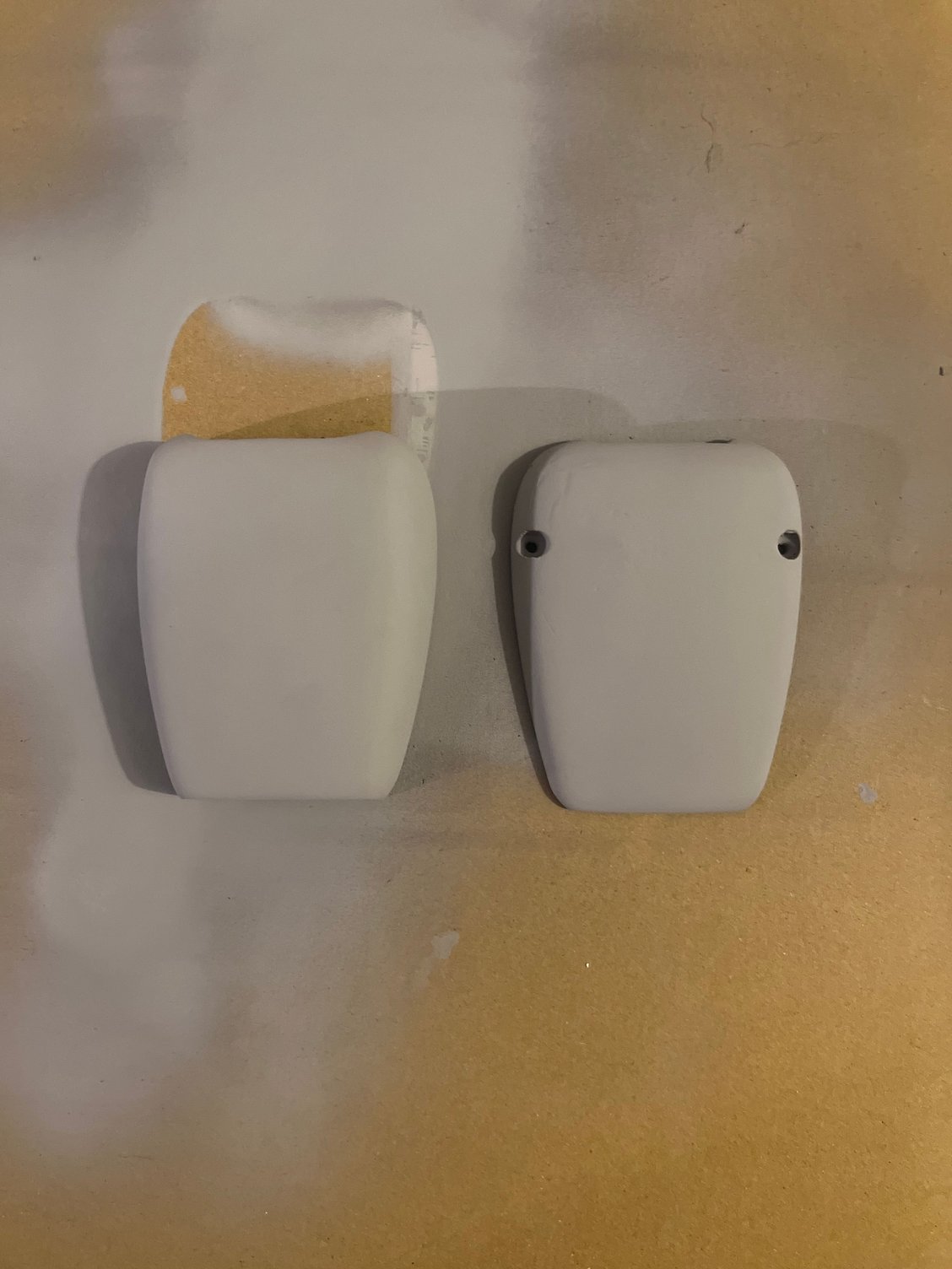

Here's a practice run with priming. I first attempted the right piece, which has a couple small defects in the primer coat due. My mistake. Second practice was done with the part on the left and turned out much better.
Tomorrow I will give it another go with a second set I have on hand to see if I improve. The important thing is that the print lines are not visible.

Order books are officially closed. Final tally, including my own, is 30 seat-belt buckle covers. I notified Anthony about the total amount that he will be printing. I will update you when he hands me the buckles. Please start sending your payments now so that I can pay him. I already started pm'ing some of you the payment details.
Final price per buckle is: $37.33, which works out to $74.67 for a pair.
For those of you ordered four, you will be paying: $149.33.

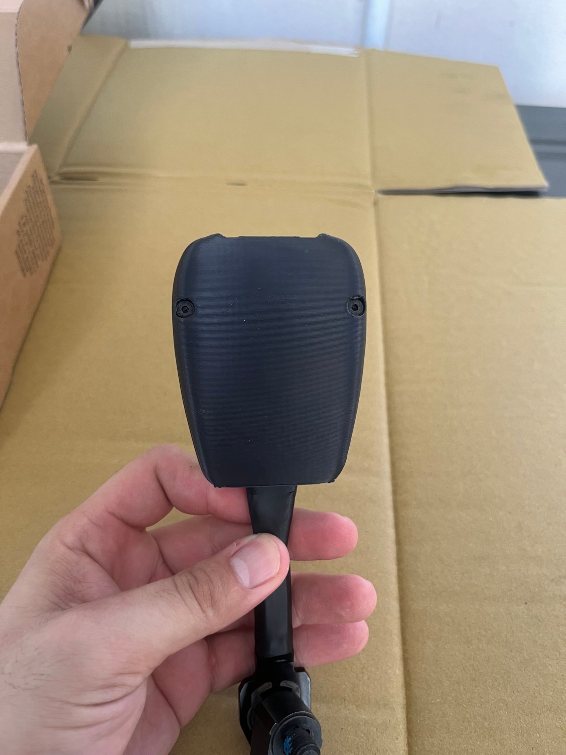

Once Anthony has printed the entire batch and handed them to me, I will be sanding and applying primer to the buckles so that when they arrive on your end, they are ready to paint. The buckles will be supplied with two Allen screws which will fasten both sides together.
I have to say, I am surprised by how tough and sturdy they are. I accidentally dropped one from a height of 3 feet, and it doesn't even have a scratch. It just bounced off the floor and shrugged it off like it was nothing. The plastic is also surprisingly hard to sand. Takes me a bit longer than I expected.
