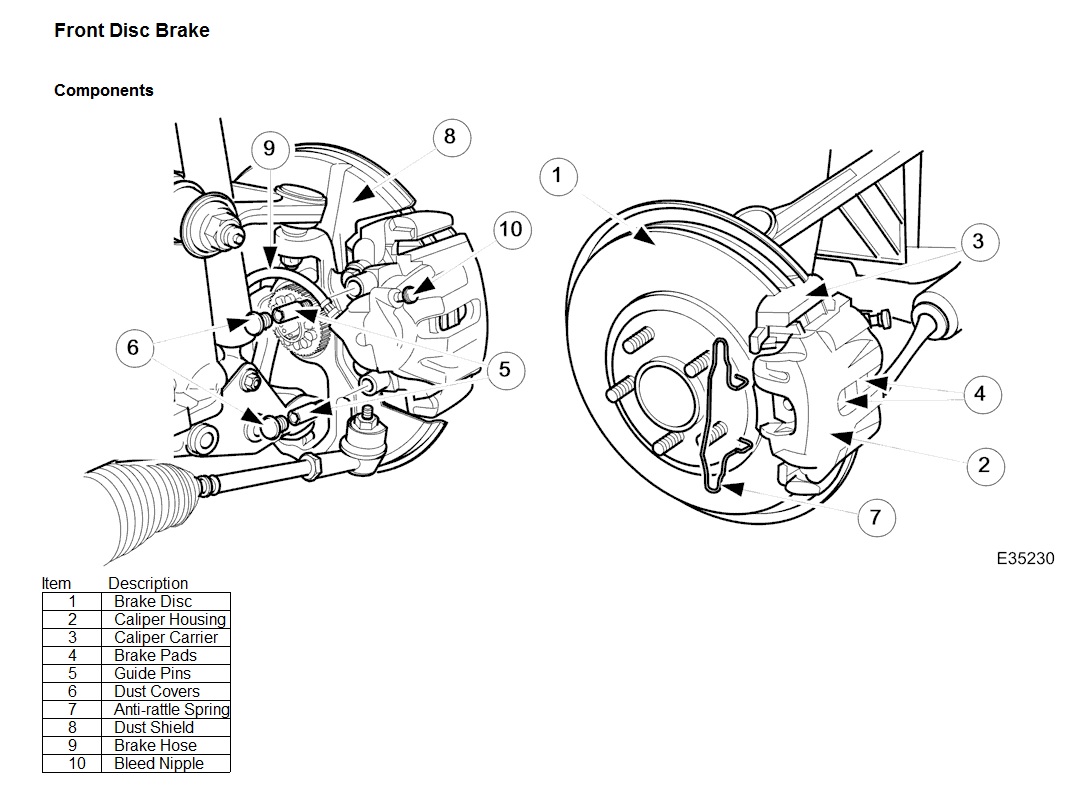

Old Aug 26, 2015 | 02:35 AM
+1
In our damp UK climate the Guide Pins (item 5) often get patches of surface rust which can make the caliper stick.
If this is the cause of your problem, the Guide Pins can be usually cleaned up with fine 'Wet & Dry' and lubricated with a minimal coating of Coppaslip.

Originally Posted by GGG
+1
Attachment 117690
Hi,
I done the push pull test with the pads out, it was a little stiff, I took the guide pins out and gave them a little clean. They easily slide back and forth now with little effort.
Thanks for the suggestion.
