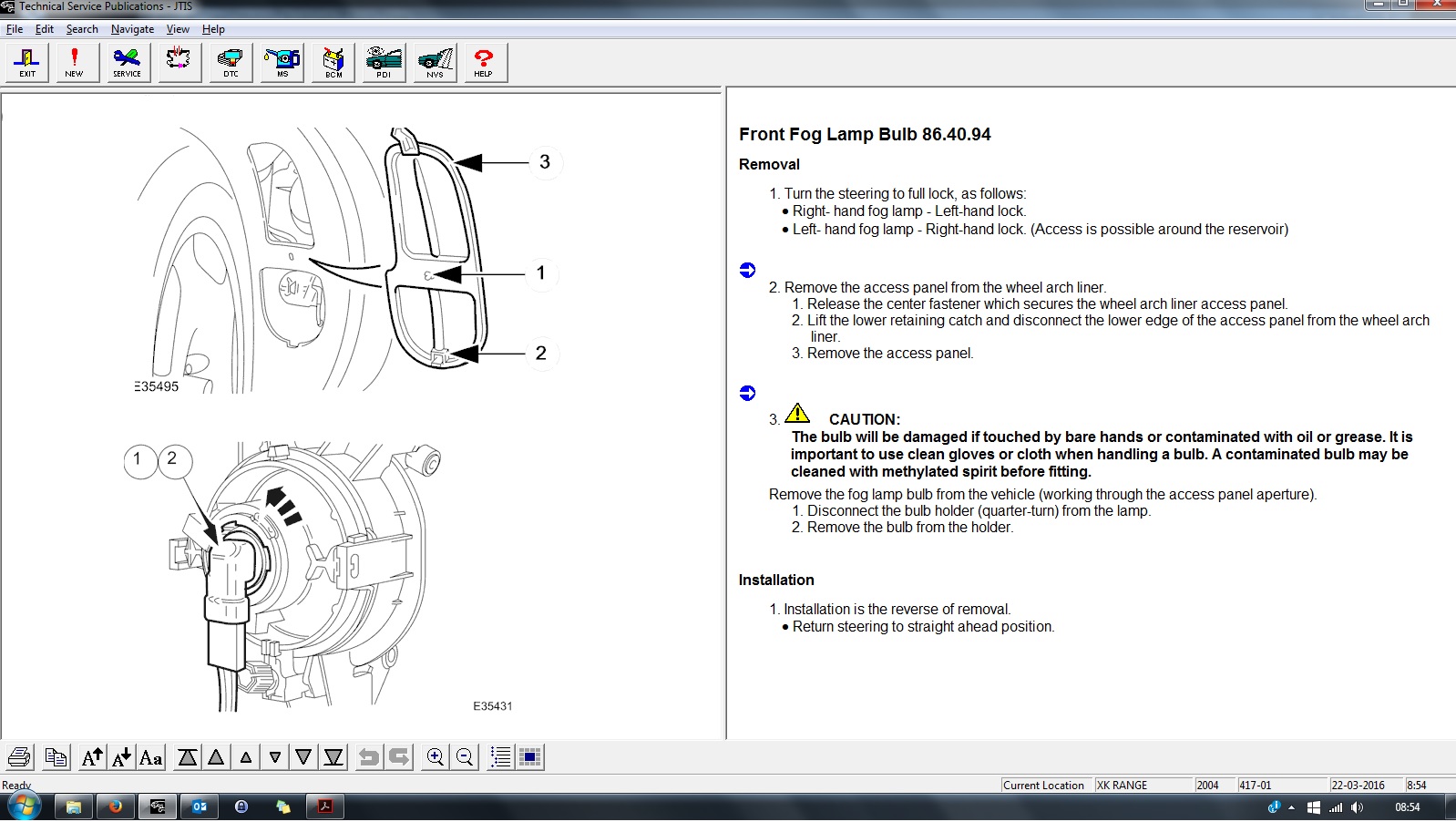

Please, could someone tell me how to replace the front fog light bulbs
I checked fuse... All OK
my dash light on consol switch is on... But no fog light... And I can not turn it off..or on dash light still there
Or could it just be a " jaguar electrics" phantom

NOTE: the front fog lights only work with the sidelights or headlights switched ON.
I hunted and searched through the Driver's Handbook for your model year..... and also found nothing on front fog light bulb replacement!
The procedure is in JTIS:
The bulb specification is in the Driver's Handbook - 12V 55W Halogen H3 Long Life.

THANK YOU GRAHAM!!!
We too had looked in the drivers handbook.. and it said to take to dealer .
So where could we get a hold of a JTIS.???(which stands for?)
Looks like it is a very good resource.
