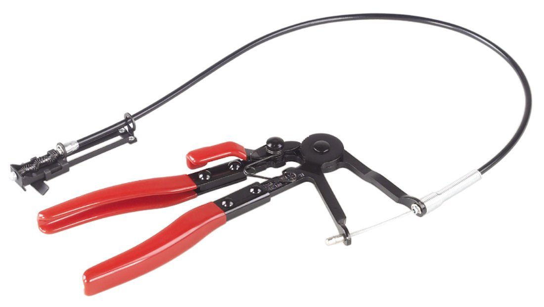

I have the spring clamp pliers that make removing and installing the clamps very easy.
