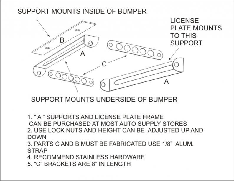

I have a front plate bracket that mounts low on the front bumper. It's easy to fabricate. I'll post a print tonight when I get home. It's adjustable so you can raise it or lower it. It does require two holes in the bottom of the bumper. I don't use it, I just carry it around in the trunk. It worked good when it was installed but, it was easy to hit curbs and parking blocks. It was more of a hassle since I only drive the car on weekends, I take my chances.

Here's s simple solution for the license plate mount. It will require two holes on the lower lip of your bumper. I don't run the plate any more and you really cannot see the holes.

Hey, Doug. Thanks a ton for following up with this diagram. One question: Did you have any support at the top of the plate or was the combined stiffness of the frame and plate enough? I might adhere a small strip of felt or rubber to the bumper up there and just snug the plate into it. (I have the 3M clear vinyl "bra", so the paint is protected.)

When sandwiching the 1/8" aluminum, the bumper, and bottom bracket, it is stiff enough to support the holder. My neighbor bought the electric one for his newer Corvette but never got it to work properly, he then bought a similar one that folds under manually. I think both were made of ABS plastic.

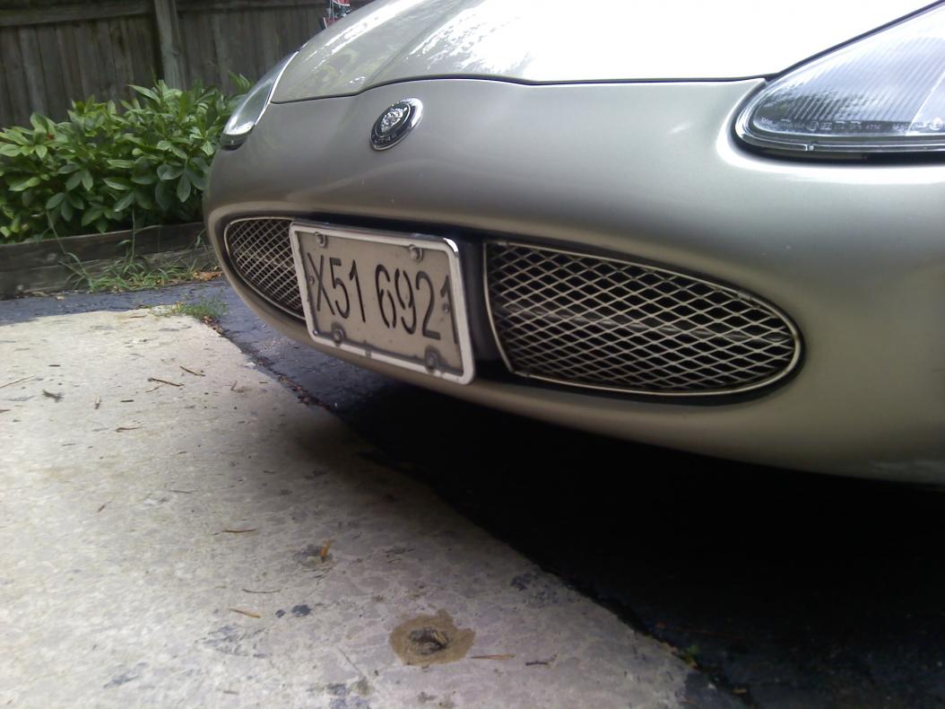

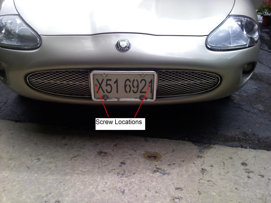

I lost my front plate twice using the factory mounts, then decided to take matters into my own hands. Plus the factory mounts looked horrible as it spaces the plate so far out.
I had to drill two holes in the plate that ligned up with the center of the bumpers. Then I used coarse thead stainless steel self tapping screws to mount it. Been there for 6 months and it's still there. I did drill small pilots holes through the plastic to get the screws started.
Have to have one unfortunately as the don't give warnings by my shop, just tickets. Lost my plate and got a ticket.

Dan, expanding on your solution, could you have moved the holes towards the center of the plate a bit farther and missed drilling into the 'teeth' altogether? Maybe run a fastener of some sort to the horizontal bar behind it?

There were already a bunch of holes from the original factory mounts, so it wasn't a concern for me. It may work for someone else though.

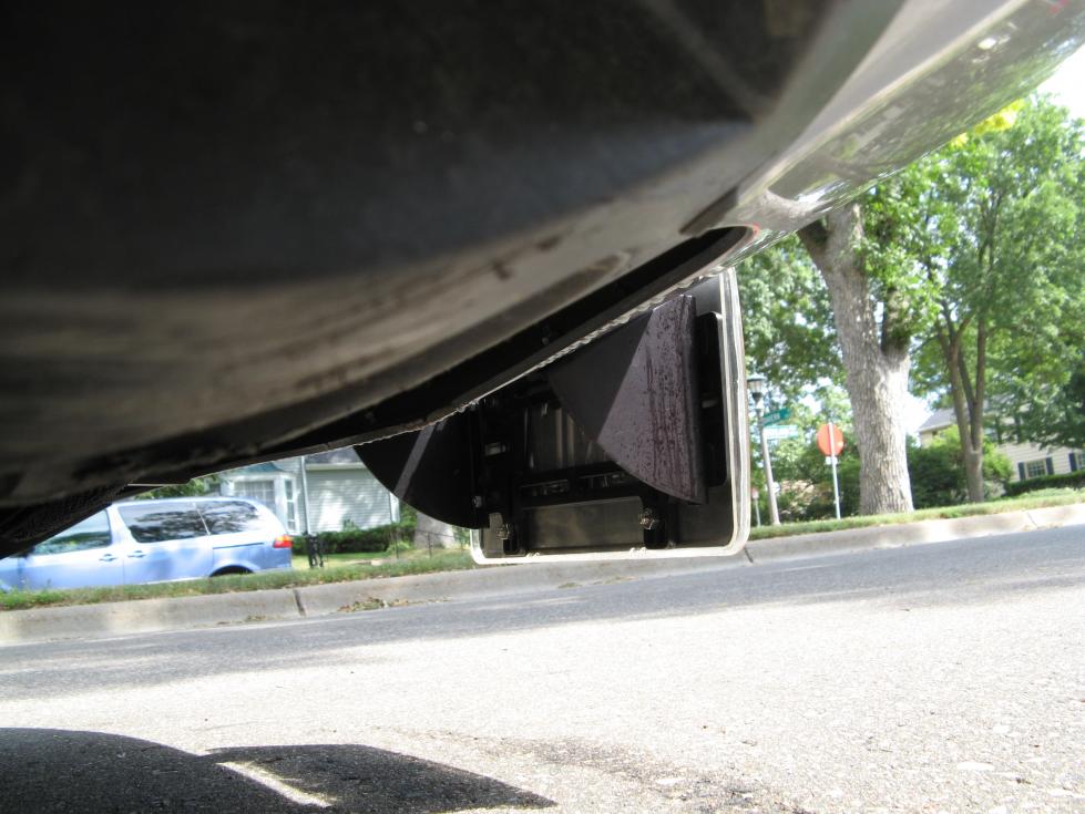

Adamesh has a set of brackets to lower the mounting of the plate.
http://www.adamesh.co.uk/jaguar-xk8-...h-kit-18-p.asp
It's pretty simple and anyone that has a brake and alumium sheet stock could make a quick set,they don't need to be well finished.When you mount the brackets to the plate,make sure that when you put it up to the bumber you monut it as high as possible to give you ground clearence on the bottom of the plale.
To fill in the holes where the original plate mount was I just put in flat black sheet metal screws which blended in from a distance.
