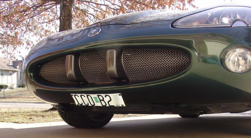

There's a local "lake community" that I often must drive through - in a suburb of Kansas City. Within six years, I have received three $75 tickets for not running a front plate (That's one of the ways, along with their well known speedtraps and kangaroo court that the little community lines their pockets with money.)
I have finally acquiesced by putting an hideous license "wart" on the front of my beauty. Here's the way I've been getting around the BULLSH*T requirement for the last two years.
I took the standard sized USA state plate and clamped it in a sheet metal brake right at the edge of the top of the embossed letters/numbers. I bent the top of the aluminum plate backwards about 80 degrees, unclamped it and flattened it the rest of the way. The did the same thing to the bottom edge.
Took me about 30 minutes...
I ended up with a European shaped plate that I formed to the front middle of the lower valence. I used stainless and brass hardware I had laying around the shop to mount it (at a slightly downward facing angle) to the plastic. Yes, I had to drill four 1/4 holes, but the result turned out (I think) pleasing - and I've not be hassled since.
It worked for me.
