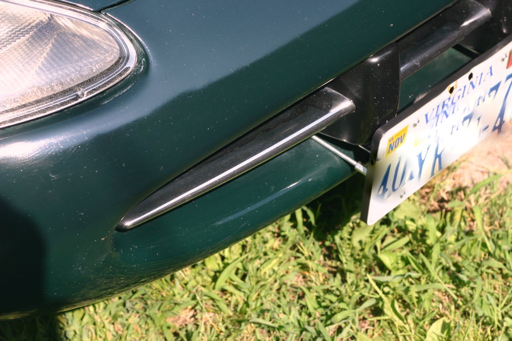

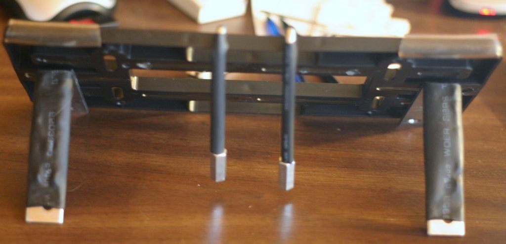

Yes I came up with a nice solution as I didn't want to drill any holes or completely block the center grill. (Drilling holes would be sacrilege) And for about $15 in parts.
Things needed:
A universal mounting plate adapter, about $5 at Auto Zone, MalWart etc, it seems they all carry the same one.
From bLowes or Homer Despot:
(2) 3" "L" brackets
(2) 3" X 1/4" X 20 threaded rods with open hooks on one end.
(2) 1/4 X 20 threaded standoffs
1 package of 1/2" X 1/4" X 20 screws
1 package of 1/4" washers
1 heat-shrink assortment from Hazard Freight.
Some scrap 3/8 tubing or gas line.
Pretty self explanatory -
Mount the "L" brackets to line up with over-riders and cover with heat-shrink.
Cover threaded hooks with heat-shrink or gas-line. Thread standoffs part way on to their ends.
Sllt a 2" long piece of gas-line lengthwise and slip over inside lower lip of grill close to Outside of each over-rider.
Put hook over the slit gas line (so it doesn't wear through lip)
Wedge "L" brackets under over-riders.
Slit 2 more 2" pieces of fuel line and put on back edge of backing plate where they will sit on over-riders (prevents them being scratched.
Screw other end of standoffs into backing plate. and tighten as needed.
Install plate to backing plate,
This is solid as a rock. No drilling, cutting or excessive cussing required. Totally reversible.
Oh, and don't try and put the threaded hooks on the insides of the over-riders to hide them. It doesn't work because it collapses the backing plate and you cant tighten it so it just flops around.
Some pics....
The last pic shows a detail of how the hook goes. (before I put shrink on it to prevent scratching)
I'll try and do some better ones later.
Dave
